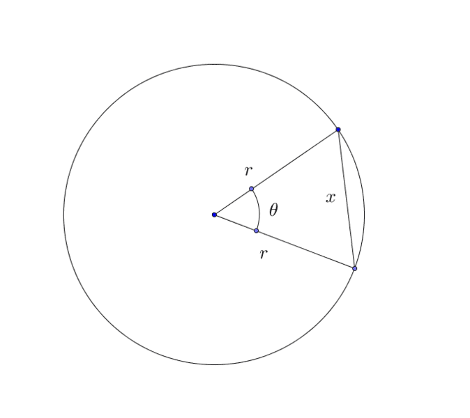

bobie said:
- if the body travels for a radians, isn't the displacement = r? if not, how do you calculate it?
If you know the radius, and the angle [itex] \theta [/itex] then you can calculate x with [itex] x = 2r\sin \frac{\theta}{2} [/itex]. So if a particle travels an angle theta along the arc, then its displacement is x.
Likes 1 person
