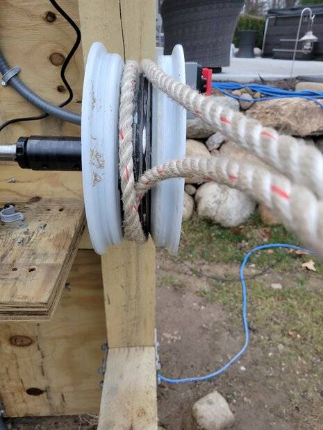

Hello -
We are building a backyard tow rope for my course. All of the electrical components are working as designed; however, the pulley can't consitently grip the rope when only placed around the rim. When looped around 1.5 times the rope continually shifts underneath itself causing the motor and drive shaft to bind.
Any thoughts on what is causing this issue or other components that could be added to the system to improve performance?

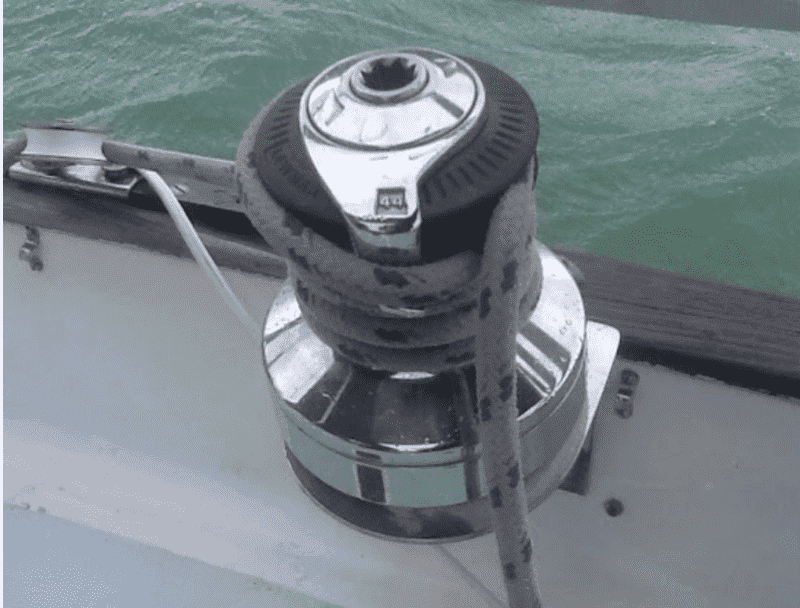

Both ends of the rope need to be kept in tension at all times. Also, fairleads can help to prevent the rope getting so far out of position.
In this picture you can see a white fairlead pulley on the left. That leads the rope into the winch at the correct angle, regardless of tension.
You can also see the final wrap of rope at the top of the winch goes over a finger, then through a pinching device at the top. The purpose of all that is to maintain tension on the loose end.
On occasions where that goes wrong and the rope feeds under itself, it can be very difficult to make right again.

I have the bottom idler tensioned with a ratchet strap. Are you thinking that isn't tight enough? I will take some pictures this evening and post.

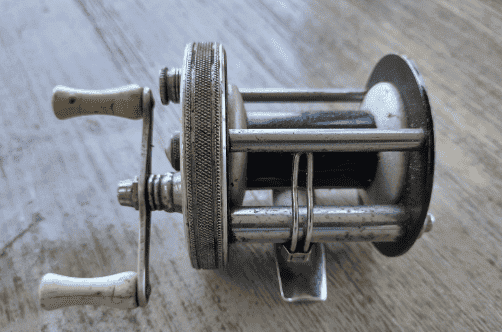

I forgot, there's another possibility. Note the guide on this casting reel. It is a fairlead that moves left/right as you reel in to prevent the line from crossing itself.
In the video the drum of the spinning reel moves up and down as you reel in to prevent the line from crossing itself.
So I think we need more details on your setup and your problems before we can give an accurate answer.

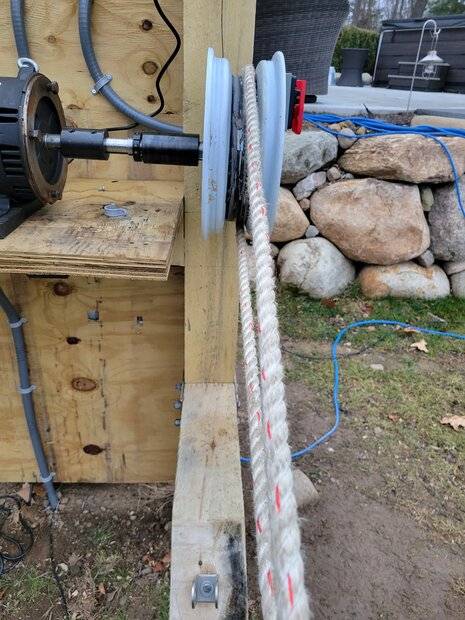

The birds nest in the fishing reel isn't the problem as it is only looped around the drum once; however the rope always finds away to cross over itself within a few revolutions. I didnt have the entire rope under tension at the moment but here are a few pics that may help illustrate:

The fundamental problem is that the "middle" wrap needs to continuously slide sideways while under tension. It cannot slide sideways because it is under tension, so the incoming rope goes over the top of the "middle" wrap, travels around, and comes out pinched underneath exactly as shown in the lower photo. You can see this by wrapping a piece of rope around a round object, then turning the round object.
The equation that summarizes the problem is ##T_1/T_2 = e^{\mu\theta}##, where
##T_1## = rope tension on the tight side
##T_2## = rope tension on the slack side
##e## = Euler's number = 2.71828
##\mu## = the coefficient of friction between rope and pulley
##\theta## = the angle of wrap in radians
A pulley driving a belt or rope only works when there exists tension on the slack side, "back tension". That is because the drive pulley has a limiting ratio of tight side to slack side tension, as shown in the equation above.
When one wrap of 180 degrees does not provide enough "grab" to pull the rope properly, you have some options:
1: Tighten the rope. The tension ratio stays the same, but the difference between the tight side and slack side tension increases.
2: Drive the rope with a V-belt pulley. The rope wedges between the sides of the pulley, which increases the tension ratio by about five times for the same angle of wrap. The wedging action is the principle of V-belts. Make sure that the rope does not bottom in the pulley - it must be supported by the sides in order to get proper wedging action.
3: Increase the coefficient of friction by gluing rubber to the pulley.
4: Increase the angle of wrap using an idler pulley as in the sketch below. The idler pulley should have the largest practical diameter, ideally the same diameter as the drive pulley. The idler pulley should be on the slack side.

Thank you very much. The rotation is opposite with the bottom rope being wrapped and the top rope exiting the drive. Does that change the location of the pulley?
Also, could I mount a smaller idler pulley on a pole as show that would feed the bottom rope around the pulley at a higher point.

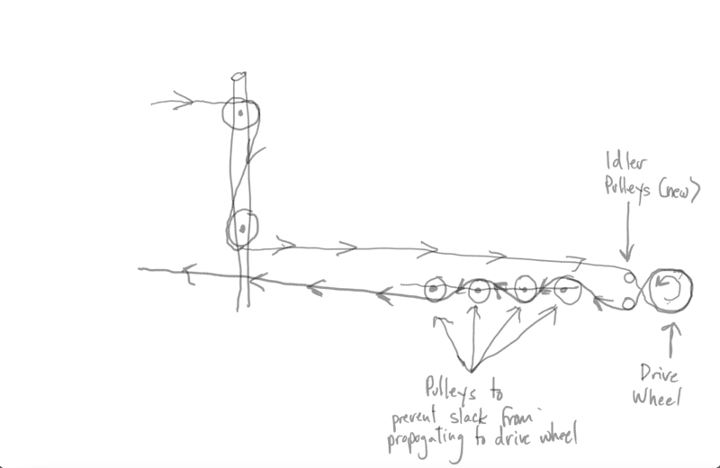

I have a very, very similar setup to rlay023's. I use almost exactly the same rim to drive my rope. And I also have experienced the very same problem: to get enough friction to drive the rope, you need to do two wraps; but a skier abruptly weighting the rope will cause slack that propagates and causes the knotting (sort of like a Munter Hitch) that rlay023 describes. I do agree that the channel in the center of the rim may contribute to knotting....
It looks to me as if rlay023 may already have tried increasing friction by putting tape around the center of the rim. I have tried that, but rope/rubber sheeting quickly degrades and isn't a solution.
I've also thought about adding one or two idler pulleys, but it seems to me that the most one can accomplish with idler pulleys is basically ensuring a little less than 360 degrees of contact with the drive wheel. I'm not sure if that's enough friction to prevent the rope from slipping. Is there a calculation I can do to figure out how much friction I'll produce/will need to propel 2+ skiers uphill?
I've had two other thoughts. One (reflected in the black-and-white sketch) is to add a series of pulleys on the uphill/skier (non-returning) side of the rope through which the rope is threaded. My theory is that those pulleys would prevent the slack from propagating back to the drive wheel and would stop knotting. I've attached a rough drawing to try and show what I'm describing (and I'm assuming that the slack is coming from the skier side of the rope, which I'm pretty sure is the case).

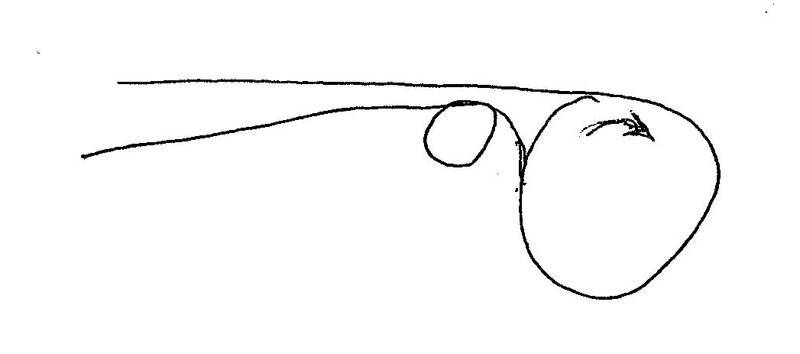

My second idea (reflected in my v. rough sketch that uses multiple colors to try and clarify what I'm talking about) is to add one or more freewheels in front of the drive-wheel and run one or more loops around them. They'd serve the same purpose as idler wheels, but my thinking is that by running two wraps around the freewheels, you could basically have three (partial) wraps around the drive-wheel, which would give you more friction. One alternative in that case would be to have multiple drive wheels in parallel, so that each new wrap goes around a different drive-wheel, thus eliminating the risk of knotting.
No pulley arrangement will prevent slack from propagating back to the drive wheel. You could, however, put a spring loaded pulley on the slack side that would take up the slack to maintain constant tension on the slack side.
FCStorm said:
if I doubled the circumference of the drive wheel
No change in maximum pulling force. The maximum pulling force is a function of slack side tension, angle of wrap, and friction coefficient as discussed in Post #8.
If you can make the arrangement in your second sketch work, the total angle of wrap on the drive pulley will be 500 to 600 degrees, or 9 to 10 radians. You might run into trouble with the belt interfering with itself.
