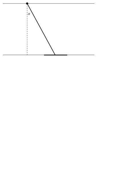

Hello,
A uniform bar of mass m is hinged to the ceiling and rests on a smooth floor at an angle α with respect to the vertical axis (please see attachment). A thin sheet of paper, with coefficient of friction μ, is inserted between the floor and the bar.
What is the minimum force necessary to pull the paper to the right?
What is the minimum force necessary to pull the paper to the left?
Obviously I must figure out which forces are in action before analysing the torques.
The forces acting on the bar are:
N1, in the positive y direction (i.e. up), at the point where the bar is in contact with the floor; fs, acting on the bar at that contact point with the floor, in the negative x direction (i.e. to the left); W, from the center of mass of the rod, in the negative y direction. Is that all? Are there any forces acting on the bar at the point where it is hinged to the ceiling?
If you pull on the paper to the right, in which direction does the force of friction act on the bar?
In general there will be both a vertical and horizontal component of force on the bar from the hinge.

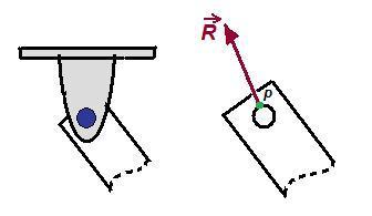

First, are the "vertical and horizontal components" referred to those of a normal force exerted on the bar by the hinge? I am not sure I completely understand the origin of this force. Would you please care to explain?
peripatein said:
Alright, so let's pull the paper to the right :-).
Yes, you can think of the force acting on the rod at the hinge as a normal force from the surface of the pin that goes through the rod. See attached figure. The rod rests on the surface of the blue pin. The pin supports the rod with a normal force ##\vec{R}## acting at point p where the rod makes contact with the pin. The 3rd law implies that the rod exerts an equal but opposite force on the blue pin.
Alright, that's clearer. Our focus is nevertheless restricted, vis-a-vis this particular question of course, to the forces exerted on the rod, is it not?
Now that we're synchronised, and before I complete the force (and torque) equations, would you please explain why the static friction would not be to the left?
peripatein said:
...would you please explain why the static friction would not be to the left?
If you stand on a rug on the floor and then I slowly pull the rug horizontally to the right over the floor, you will ride the rug to the right. What force caused you to move to the right?
I see where you're going, but isn't the direction of the friction generally opposed to that of the movement?
As far as the paper is concerned, the friction opposes the motion of the paper. As you pull the paper to the right, the friction force on the paper acts to the left. But friction on the rod acts to the right.
Similarly, if you have a block sliding to the right along a rough floor, the friction force on the block will be to the left, but the friction force on the floor will be to the right (the same way the block is sliding.)

All right then, moving on to the equations I believe we would have:
N1, in the positive y direction (i.e. up), at the point where the bar is in contact with the paper; fs, acting on the bar at that contact point with the paper, in the positive x direction (i.e. to the right); W, from the center of mass of the rod, in the negative y direction; N2cos(alpha), in the negative y direction and N2sin(alpha) in the positive x direction, both designating the forces exerted by the hinge on the rod.
Now for the torques (choosing the point where the bar is in contact with the paper as my reference):
(L/2)*mg*sin(alpha) in the positive z direction
Am I missing something?
We don't know the angle that N2 makes to the vertical. It's probably not alpha. I would recommend replacing N2 by it's horizontal and vertical components: N2x and N2y
You'll also need to include the torques due to N2x and N2y.
[EDIT: You might find it easier to set up torques about the point where the rod is hinged to the ceiling. Then you won't need to worry about N2x and N2y.]

Okay, so now I have the following three equations:
(1) mg + N_2_y - N_1 = 0
(2) mu*N_1 + N_2_x = 0
(3) l*mg*sin(alpha) + 2l*mu*N_1*cos(alpha) + l*N_1*sin(alpha) = 0
Which leads to f = mu*N_1 = -(mg*mu*sin(alpha))/(sin(alpha) + 2mu*cos(alpha))
May you please confirm? (This is for the paper moving to the right)
You have the same sign for all three terms, but not all of the torques are in the same direction.
Looks like you multiplied both sides by 2 in order to get rid of a factor of 1/2. But then wouldn't the last term on the left side have a factor of 2?
Everything else looks fine.
You are right, this is inexcusable :-). I meant to write:
F = (mu*mg*sin(alpha))/(2sin(alpha)+2mu*cos(alpha))
Is it correct now?
peripatein said:
YI meant to write:
Is it correct now?
That looks like the correct answer to me. Good!
