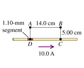

A straight wire caries a 10.0−A current (the figure(Figure 1) ). ABCD is a rectangle with point D in the middle of a 1.10−mm segment of the wire and point Cin the wire. Find the magnitude and direction of the magnetic field due to this segment at the following points.
dB = μ*i/4*pi*r ds
B = μ*i*L/4*pi*r
to find the magnetic field at A, would i integrate along ds to get to the second equation then plug in the necessary information?
Integrate the first equation over the 1.1 mm length indicated. Use the vector form of the B-S Law to properly capture the geometrical relationship between the current element and the observation points. Your second equation is only valid for the field away from an infinitely long current--not your situation.
okay, so would i get that my radius = 5cm as well?
Well, r is distance (diagonal) from source to observation so it varies.
