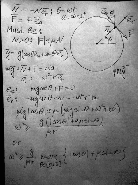

Right, but you do not know at what point in the rotation is the greatest risk of slipping. So you need an expression for that vector at a general position. My preference wouldbe to stick with the usual Cartesian coordinates. If you prefer to work with cylindrical here then the challenge, instead, is to represent gravity in those.
As zwierz did, I have ##N=m \omega^2 R-mg sin \theta ## and ## N= \frac{mg cos \theta}{\mu}## and then ##\mu \geq \frac{g cos \theta}{\omega ^2 R-g sin \theta}## and so ## \omega^2 R \geq g sin \theta ## because the denominator must be > 1 (otherwise the fraction would be > 1 and the block would slide)

zwierz said:
my result is different as well
The final solution must be ## \omega^2 R \geq g\sqrt{1+ \mu ^-2} ##

The expressions ##\omega^2 R \geq g(cos \theta \mu^-1+ sin \theta) ## and ##\omega^2 R \geq g \sqrt{\mu^-2 +1}## aren't they?
Find a maximal value of the function ##f(\theta)=|\cos\theta|+\mu\sin\theta##

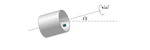

I'm trying to decompose the 3D vector ##\vec{g}## but I don't know how to figure out it! Any help?
If ##\hat{u}## is a unit vector in some direction, then the component of a vector in the direction of ##\hat{u}## can be found from the dot product of the vector with ##\hat{u}##.
Is it possible that the components are ##\vec{g} (g cos \theta, g sin \theta, g cos \alpha)##?

Describe your coordinate system.
A vector ##\vec{u}## is defined by ##(\vec{u_{x}}, \vec{u_{y}}, \vec{u_{z}})##
Yes. But the values of the components depend on the orientation of the axes. So, you need to describe the orientation of your choice of the x, y, and z axes.
One thing that must be true is that ##g^2 = g_x^2 + g_y^2 + g_z^2##. Is this true for your expression ##\vec{g} = (g cos \theta, g sin \theta, g cos \alpha)##?

OK, I'm not sure I follow your description of the y axis. Suppose you pick the axes as shown below for ##\alpha \neq 0##. The z axis is the axis of the cylinder and the yz plane is vertical. The x-axis is then horizontal.
How would the components of ##\vec{g}## be expressed in this coordinate system?
When the block is at the angle ##\theta## shown, what would be a unit vector in the centripetal direction?
Use these vectors to find the component of ##\vec{g}## that is normal to the surface when the block is in this position.

I tried applying the same procedure for part b I decided to work with cylindrical coordinates with z axis being similar to your and r and theta axis being the usual one along the plane of cylinder
g_z = g sin \alpha\\
g_{r,\theta} = g cos \alpha \\
so the radial equation is the same as before except g changes
f_r = 0 = N + mg cos\alpha sin \theta = m w^2 r\\
N =m w^2 r - mg cos\alpha sin \theta \\
now there is two components of friction F_theta and F_z whose comined modulus must be less than \mu N
F_\theta = mg cos \alpha cos \theta\\
F_z = mg sin \alpha \\
\sqrt { F_\theta ^2 + F_z ^2}\\
\sqrt {(cos \alpha cos \theta)^2 + sin \alpha ^2} <= \mu(\frac{w^2 r}{g} - cos \alpha sin \theta)\\
cos \alpha(\sqrt {(cos \theta)^2 + tan ^2\alpha } + \mu sin \theta)<= \mu(\frac{w^2 r}{g} )\\
after long differentiating I am getting
sin \theta = \frac{\mu sec \theta}{\sqrt{\mu^2 + 1}}\\
cos \theta = \sqrt{\frac{1 - \mu^2 tan^2 \alpha }{\mu ^2 +1}}\\
plugging back in I get exactly same answer as first part of the problem what am I doing wrong

I noticed a couple of typographical errors for part (a) which did not affect your subsequent work:
vishnu 73 said:
## cos \theta + sin \theta \mu <= \mu \frac{m w^2 r}{ g}##
##\sqrt {\mu ^-2 + 1 } <= \frac{m w^2 r}{g}##
There should not be a factor of ##m## on the right side of the above equations.
Otherwise, the rest of your work looks good except that you need to deal with the following important situation in part (b):
What happens if the quantity inside the square root is negative?
