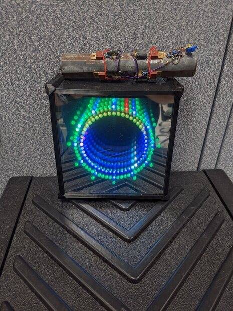

I actually have two 10MHz Rubidium Frequency Standards, one I built into a Nixie Tube clock. I will try to upload my infinity astronical clock I made with NeoPixels.
So the clock will be a regular clock:
(AM/PM) HH:MM:SS
Flight Time DD:HH:MM
ship acceleration setting (+3g,0,-3g )
V(%c) display 0.999999
time offset from launch side:
DD:HH:MM:SS:MMM:UUU
and it will need to have a DNS switch
https://www.adafruit.com/category/275​

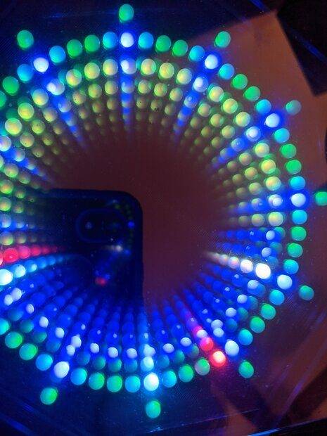

this is my NiePixel Astronomical clock.
outer ring is Seconds (Green), Minutes, (Red)
Inner ring is Hours (Red), position of sun in sky (bright Yellow), position of moon in sky (Aquamarine), the yellow band is hours of daylight for that week of the year, based on latitude for that week
