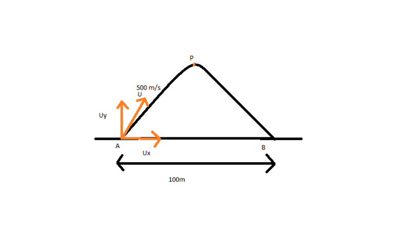

[/B]A person aims a gun at a bird from a point at a horizontal distance of 100m. If the gun can impart a speed of 500m/s to the bullet , then above what height of the bird he should aim his gun to hit it ?
: [/B]
[itex]H_{max}=\frac{u^2\sin^2\theta}{2g}[/itex]
[itex]R=\frac{u^2\sin2\theta}{g}[/itex]
3. The Attempt at a Solution :
Range= [itex]R=\frac{u^2\sin2\theta}{g}[/itex][itex]\implies \sin2\theta=\frac{Rg}{u^2}[/itex][itex]\implies \sin2\theta=\frac{1}{250}[/itex][itex]\implies 2\theta=\sin^{-1}(\frac{1}{250})[/itex][itex]\implies \theta\approx 0.11[/itex]Maximum height=[itex]H=\frac{u^2sin^2\theta}{2g}[/itex][itex]\implies H=0.04 m [/itex]The correct answer is 20 m. Where have i gone wrong?
That is not the same as the max height reached. Draw a diagram.

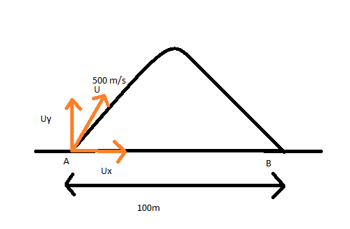

@haruspex, Here is the diagram i drew while solving this problem,
Ok, so show on it the point above the bird that the person aims at.
donaldparida said:
@haruspex, Why?
If you point a gun in a certain direction, in what direction do you expect the bullet to emerge from the muzzle? What direction is that in your diagram?
The direction of [itex]\vec{U}[/itex]?
Likes CWatters
Yes. So P is a point in that line and vertically above the bird.
