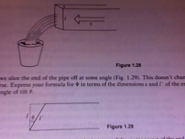

Okay, so this was Part 1:
Water flows with a speed v down a rectangular pipe of dimensions s and l as shown. What is the rate
at which water accumulates in the bucket? (figure 1.28)
... which I solved as follows:
[tex]\phi=\int_{Surface} v \cdot da[/tex]
[tex]=\int_{Surface} v*da\cos\theta[/tex]
[tex]=\int_{Surface} v*da[/tex]
[tex]=\int_s\int_l v*(dsdl)=v*s*l[/tex]

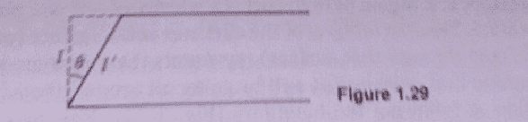

Now this is Part 2: Figure 1.29
We slice the end of the pipe off at some angle [itex]\theta[/itex]. This does not change [itex]\Phi[/itex]. Express your formula for [itex]\Phi[/itex] in terms of the dimensions s andl' and [itex]\theta[/itex].
So is the main idea of this to use only the normal component of A in the integral? (normal to v, that is).
Casey
So how about this: if da is the normal to v
[tex]=\int_{Surface} v*(ds)(dl'\cos\theta)[/tex]
[tex]=v\cos\theta\int_s\int_{l'} *(dsdl')[/tex]
[tex]\Rightarrow\Phi=vsl'\cos\theta[/tex]

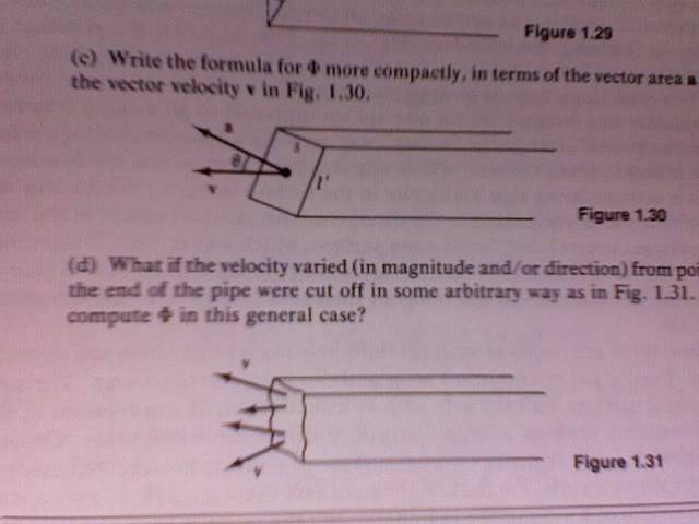

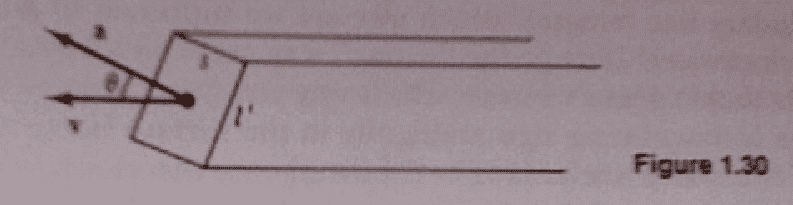

Now the next part of the problem says "Write the formula more compactly, in terms of the vector area a and the velocity vector v in figure 1.30"
I think this is just the integral I did above, but skipping the part where I substitute for da
That is [itex]\Phi=vacos\theta[/itex] correct?

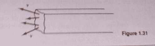

And now the last part:
What if velocity varied (in magnitude and/or direction) from point to point, AND the end of the pipe were cut off in some arbitrary way as in fig 1.31; how would you compute the flux in the general case?"
I am thinking there is a summation inside of the integrand for this one... something like:
[itex]\Phi=\int_{Surface}\sum v_o\cos\theta_o\, da_o[/itex] but I dunno... looks ugly to me

phi=v*a*cos(theta) is not correct. For the first part you got v*s*l and for the second part you got v*s*l'*cos(theta). s*l' is not 'a'. Think about it some more. What's the relation between l and l'?

s*l'=a' ---> the actual area
So... I want the component normal to v
How is s*l'*cos[itex]\theta[/itex] not the component that is normal to v?

Don't you mean the component that is parallel to v? I think the point they are trying to make here is that v*s*l=v*s*l'*cos(theta). The amount of water coming out of the pipe doesn't depend on the shape of the end. Your scan of the problem is sort of cut off. So I hope that's the point they are trying to make.

Isn't that the component of v normal to the surface a'?

Are we looking at the same diagram? Post #1 figure 1.29 ?
If v runs along the longitudinal axis of the pipe and I want the component of a that is perpendicular to it then I want v*s*l where l=l'cos[itex]\theta[/itex]
So how is [itex]\Phi=v*s*l'*\cos\theta[/itex] not correct? What (big idea) am I missing Dick?
Casey
v*s*l'*cos(theta) IS correct. v*s*l is also correct for the first case. And they are equal. ANY surface that cuts across the end of the pipe has the same flux through it. I think that's the 'big idea'. Or did you already know that and am I missing the point of this exercise?

Back to the question of how write v*s*l'*cos(theta) more compactly...
Dick, looking at this diagram
why wouldn't [itex]\Phi=va\cos\theta[/itex] be correct?
Sometimes questions can be a little obscure, but it says write it in terms of the vectors 'v' and 'a'. In v*s*l'*cos(theta) v is the length of the vector 'v', s*l' is the length of the vector 'a' and cos(theta) is, uh, the cosine of the angle between them. It's dot product, right?

It depends on which 'a' you mean. I thought you meant a=l*s from the original problem. If you mean the new area l*s' then it's fine. Looks like a dot product, doesn't it?
Sure didily does. How about this one:
The area is arbitrary and v varies with position.
I started with this: [itex]\Phi=\int_{Surface}\sum v_o\cdot\cos\theta_o\, da_o[/itex] but it looks kind of lame to me...
How about just writing the integral of [itex]\vec v \cdot \vec n da[/itex] where n is the normal vector? Or [itex]\vec v \cdot d \vec a[/itex] where [itex]d \vec a=\vec n da[/itex]? Is that what you are trying to express?

Oh sure. Do it the easy way :smile: This was the original question:
"What if velocity varied (in magnitude and/or direction) from point to point, AND the end of the pipe were cut off in some arbitrary way as in fig 1.31; how would you compute the flux in the general case?"
So [itex]\int_{s}\vec v \cdot \vec n da[/itex] would take care of it? Is that integral actually do-able? (not that it said it had to be... just curious) Since you would need to know the angle between v and a at every point...
Like I said, I think it's just the same integral you used before except now v and theta aren't constant

If you know an actual equation for the surface A and the vector field v then you could certainly write down an integral.
