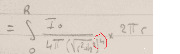

But, making an effort to clip, edit, and post a piece of your image, can you explain the exponent of 4 in your equation:
thanks, i will type from now on,it's from the inverse square law(S/(4*pi*d^4)=ir)
  • #32
Hmm. I'd say that the power is spread over the surface area of a sphere of a given radius, so the flux would go as
##\Phi = \frac{P_o}{4 \pi r^2}##
Where r is the distance from the source.
The same should apply to intensity.
  • #33
oh okay, so if i replace the 4 with a 2, the final result is i0(ln(h^2+R^2)-2ln(h))/4, does that make more sense?
thanks
  • #34
Yes, it does to me :smile:
I think you could do some manipulation of the logs to get a more concise version, but otherwise I think you're doing fine.
  • #35
that's great! i have been working on this for almost a week and couldn't figure it out hahahaha
thanks a lot!
nadi
