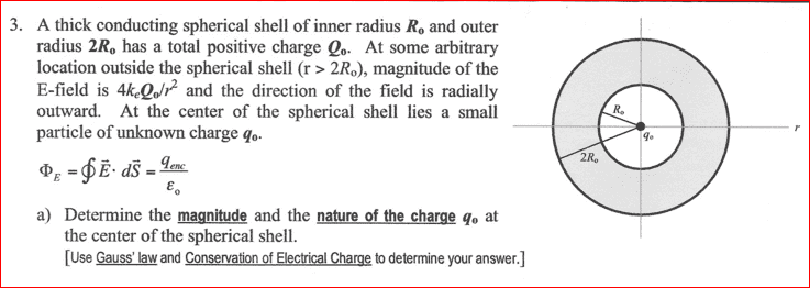

1. Homework Statement
Instead of typing it out, a link to a scanned document of the problem is here: http://imgur.com/Be3jSLp.
The equations to use are stated in the problem here: http://imgur.com/Be3jSLp
For 3.a: Wouldn't you have to draw a gaussian sphere around the outer edge of the sphere, which would yield an enclosed charge of Q_o? Then after that, wouldn't you draw another one inside the conducting shell, resulting in an enclosed charge of zero? Therefore, wouldn't the charge at the center be -Q_o?
For 3.b: Using the equation given, I don't know exactly how to integrate the equation after you substitute in the E value given in the beginning of the problem.
Any advice?

Have you tried applying Gauss's Law ?
Hi Physicsman69:
I suggest you keep the following hints in mind:
1. The total field is radially symmetric.
2. The field out side of the sphere at radius r is exactly the same as if the total charge inside
Q0 + q0
was at the center.
Hope this helps.
Regards,
Buzz
Yes, you can draw a gaussian surface outside of the sphere which would yield $$E4\pi r^2 = Q_0/\epsilon$$
And, then a gaussian surface drawn inside the conducting shell would yield $$E4\pi r^2 = 0/\epsilon$$
Wouldn't this mean the charge in the center equals $$-Q_0$$ To offset the positive charge on the surface of the shell?

Being that it is radially symmetric, the integral for Gauss' law would yield: $$E4\pi r^2$$ That is what you are implying right?
And for #2 are you saying that the unknown charge at the center, q0, would have to be opposite and equal of Q0?

For #2, this would mean that q0 would be actually be zero, correct? A charge uniformly distributed over the surface, can act like a charge concentrated at the center, therefore Q0 + q0 = Q0, so q0 = 0?
The total charge enclosed is Q0 + q0, is it not?
And, then a gaussian surface drawn inside the conducting shell would yield $$E4\pi r^2 = 0/\epsilon$$Wouldn't this mean the charge in the center equals $$-Q_0$$ To offset the positive charge on the surface of the shell?
