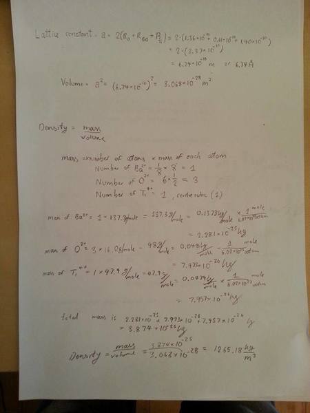

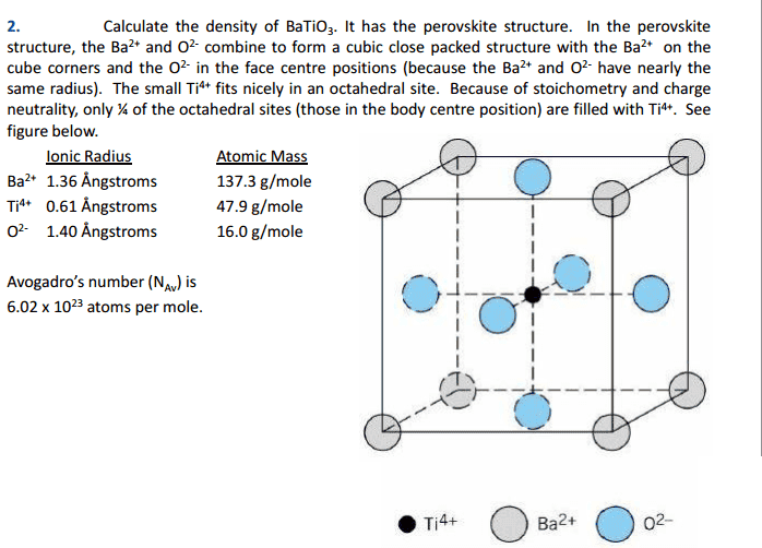

See attachment q2 for the perovskite structure
For the perovskite structure, I assume that the lattice constant is equal to 2*(R1+R2+R3) and calculate the density based on this. Am I correct? (The attachment q2ans is my attempt on the question)
No. The titanium ion is small, it does not touch the other ions. See one face of the cube and figure out the side length so as the arrangement with one oxygen ion at the centre and barium ions at the corners can be established. The lattice constant is equal to the side length of the cube.

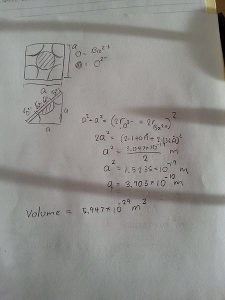

thank for your reply ehild
the attachment here is what I did by finding 'a' from a single face. I got a new value for volume which will result in higher density :D. Since Ti is so small, do I still need to include it in the mass calculation?
the attachment here is what I did by finding 'a' from a single face. I got a new value for volume which will result in higher density :D. Since Ti is so small, do I still need to include it in the mass calculation?Junks
You need to include it in the mass, but remember, only 1/4 th of the sides in the centre of the cube is filled with titanium ions.
The volume is correct now.
ehild
