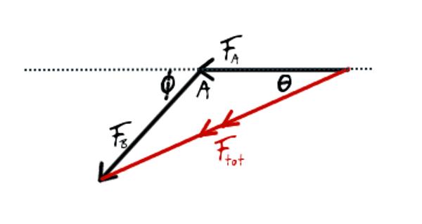

I couldn't find a vector-add diagram online that had all the elements I wanted ... so I drew my own:
... in the above, we want to do ##\vec{F}_{tot}=\vec{F}_A+\vec{F}_B## - magnitudes and directions are shown in the diagram.
We place the vectors head-to-tail.
In general ##F_A \neq F_B##:
The cosine rule says that: $$F_{tot}^2 = F_A^2+F_B^2-2F_AF_B\cos(A)$$... notice that ##A=180-\phi## (in degrees) and use the identity: ##\cos(180-\phi)=-\cos(\phi)## to get: $$F_{tot}^2 = F_A^2+F_B^2+2F_AF_B\cos(\phi)$$
Once you've got ##F_{tot}## you can use the sine rule to find ##\theta## - the direction of the resultant. $$\frac{F_{tot}}{\sin(A)} = \frac{F_B}{\sin(\theta)} = \frac{F_A}{\sin(180-A-\theta)}$$
This is not normally any more convenient that working with components ... unless...
In the special case where ##F_A=F_B=F## then ##\theta = \phi/2## and the rule becomes: $$F_{tot}^2 = 2F^2\big ( 1+\cos{\phi} \big )$$ ... which can simplify things a great deal.
In general - learn the sine and cosine rules rather than these vector ones, and get used to drawing the diagrams to guide your thinking.

Using components - defining the -x axis as the direction of FA we would write:
$$\vec{F}_A = -F_A\hat{\imath}$$ $$\vec{F}_B=-F_B\cos{\phi}\hat{\imath}-F_B\sin(\phi)\hat{\jmath}$$... then I can do: $$\vec{F}_{tot}=\big (-F_A-F_B\cos{\phi}\big ) \hat{\imath}-F_B\sin(\phi)\hat{\jmath}$$
Then it is a matter of applying Pythagoras to get the total.
It is usually felt that this method is easier for beginners. OP's mistake was leaving one of the forces out.
