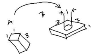

I am not getting anywhere on this one. Here is the problem at hand:
Let's say there are two SOLID objects, both made of the same material... (let's say iron).
The first object (A) is a cuboid that is 3 cm long with sides of 1 cm each.
The second object (B) is a cuboid with sides 3 cm x 3cm and is 1 cm thick.
The latter object (B) has a round hole in the center of it's 3x3 side of 1 cm in diameter.
Calculate the force necessary to insert the first object (A) THROUGH the hole in the second object (B).
I'd like to see the calculations to arrive at the solution as well.
I have attached a pic showing this.

Here are some responses by the prof:
I know you'll have to force it, and I also understand that one or the other or both of the objects would experience some deflection. If you need to substitute a material you have more data about, that's cool; I just picked Iron just because.
I don't believe both objects would "bend"... let's say object b was 200 cm thick, but keep the rest of the dimensions for both the same. Object A would perhaps deform uniformly and the take on the shape of the round hole? in otherwords it would become a cyclinder, displacing it's corner mass to the sides? Hmmm... I suppose the first thing we need to do is calculate the volume of the hole in object B and the volume of A.
What would happen if object A was left as it is,l but object B was only 2 mm thick? Would object A remain "square" and the hole would become a square?
Looks to me like the professor is expecting you to experiment. Certainly the answer depends upon the material. I would suspect the answer for steel is that it is impossible!
nothing is impossible!
you would just have to break object B a bit...(by whatever force)
for some more elastic material it's maybe possible just to bent and strech the hole. Have you tried it with some paper, or rubber?
what kind of subject is this anyway?
