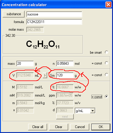

112.5 mL to be more precise :wink:
20g in 120g of solution means 16.67% w/w concentration. Put 16.67 into my concentration calculator, then enter mass of the solution and read volume:
Once you enter the concentration, solution density is automatically fetched from the density table.
You will need an additional click or two and you will need to start selecting sucrose from the program database, but all in all it is just about 10 seconds. I used 16.6667 so that mass of solute calculated by the program for a given concentration and mass of solution is exactly 20g, but it doesn't change the general idea.
