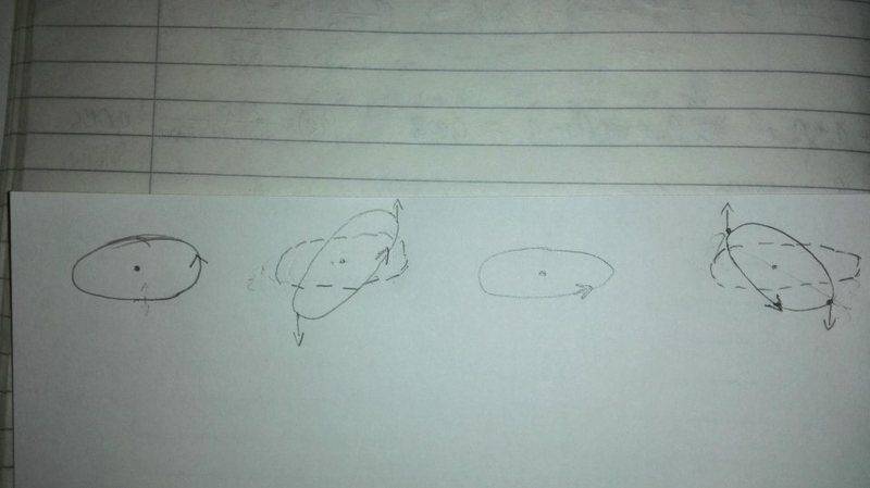

The flying disc except rotation moves up and down. Show that such movement will be suppressed by frictional force of air, which has a force momentum relative to the center of disc ##N=-K\omega##. What is the time profile of this process?
##L= T - V##
##T=Tradial + Trot + Tupdown##, ##V=0##
I haven't seen such type of problem before. So I don't know if I should construct lagrangian and generally don't have idea how connect frictional force with this movement. Probably small kick should help and probably than I will able to solve it.
Please give me some kick :) Thank you.

We can only vaguely guess what this problem is all about . If it came from a book or course work then please show the complete text and diagrams .
Nidum said:
We can only vaguely guess what this problem is all about . If it came from a book or course work please show the complete text and diagrams .
Understand, but unfortunately I have got only this text on paper. Nothing more. If we need something more maybe we can expect it and mention.
Perhaps we can synthesise a version of this problem that can be solved .
What do you think the physical system is ? Can you draw a picture ?
I'm sorry I'm not good painter :) Now I don't know if you don't know what is happening there or you advise me this way.

We'll have to leave this for now I think . Come back if you can find any more information about the problem .

It is frisbee. You throw it and it flies let's say in x-y plane (better only in x direction but it is not important in our case). When it flies it rotates around z axis with angular velocity ##\omega##. But it also moves (vibrates - I don't know how call it), swing up and down in z direction. If you ever seen a frisbee you probably know what I mean.
"Force momentum" is typ sorry, there should be moment. Not momentum.
Is it a bit more understandable?
