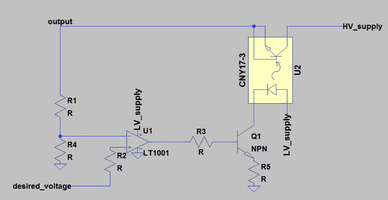

IF the application is LOW power, you can use something like this. you will have the change the part numbers, the current pn are just there to get a design in schematic form
The basic premise is you use an opto isolator to control the power coming from an hv supply. the opto isolator take the voltage drop. you need special opto isolators to do this. You can also drop the power across a powerfet or something similar. again the is for LOW LOW power.
you use a LARGE value resistor in a voltage divider (or resistor network depending on the equation you want to implement). this will allow you to put the feedback to the negative terminal of an op-amp. The positive terminal can be used as your control voltage. The bjt on the output of the fet controls the opto-isolator.
Keep in mind there are a lot more design considerations and safety considerations. this is just an architecture concept.

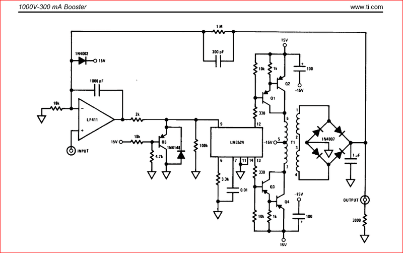

Aha i gave up too soon

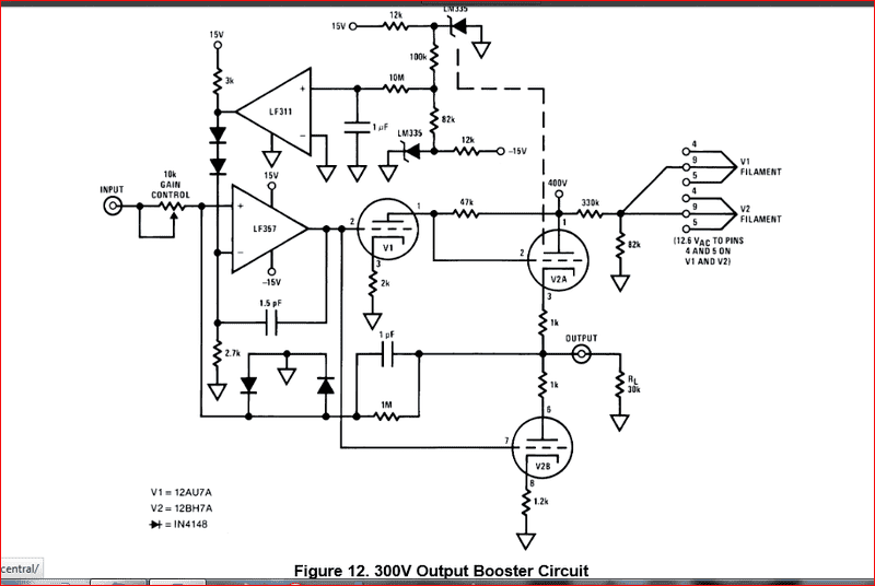

here's the one i was looking for, 2 pages further in.
same link
That 1000v-300ma booster seems pretty cool, except for that fact both of those circuits are positive voltages only :( 99.9% of the voltages I'll be dealing with are negative. A DC-DC converter does seem like an interesting idea though, perhaps if I can convert DC into ac and then run it through and transformer and convert it back into DC I could have the multiplied voltage I need.

Thanks for that, I'm currently in LTSpice trying to get Donpacino's circuit to work. I can't seem to get the output voltage to exceed the input voltage, I think my crappy understanding of transistors and opamps is getting in the way here.
Will I be able to multiply voltage and not just offset it?
Wait so is R2 the input or? I can't seem to get it to function the way I want it.
What are the values of your HV_supply and LV_supply?
BoB
the voltage divider R1 and R4 will determine the gain of the signal, the transfer function being output/desired_voltage. the R2 input would be your desired voltage. It can be an output from a microcontroller, a potentiometer with a voltage divider, whatever. There will be a linear transfer function between desired_voltage and output dependent on the value of R1 and R4.
Even though there are non linear elements that function will remain linear as long as a circuit element does not saturate. like I said before I just used LT spice to draw a quick and dirty schematic. You'll need new part numbers.
The HV_supply will just have to be a dc voltage source that can source a high enough voltage.
LV supply can be 5-15 volts depending on the op amp and opto isolator.note: I failed to notice that your supply has to be +/- 150. This will not work for a negative voltage, although you might be able to use similar concepts to get something to work.
same link

you might misunderstand the purpose of this circuit :/
This is not a supply, it is a regulator.

looks like a follower with gain 1+R1/R4

jim hardy said:
Hmmmm, that seems too good to be true, I'm wondering what the catch is, all the rest are hundreds of dollars and my 45v "high voltage" opamp I use right now costs $11. Would that opamp serve well as a DC offset servo?
coinmaster said:
Hmmmm, that seems too good to be true, I'm wondering what the catch is.
Well their metal cased power boosters are $150
this one is plastic - maybe that's why it's so cheap...
