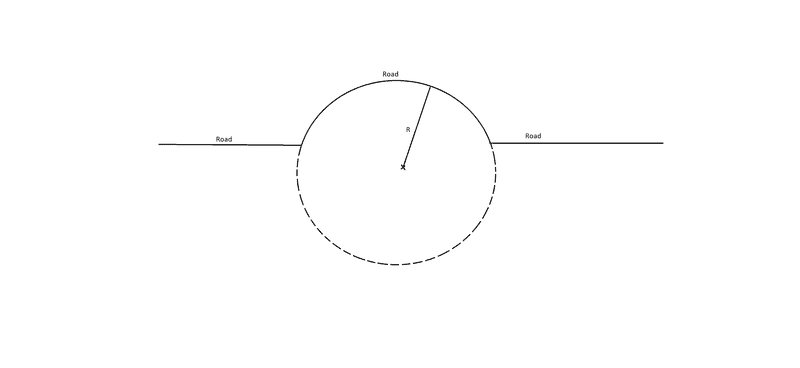

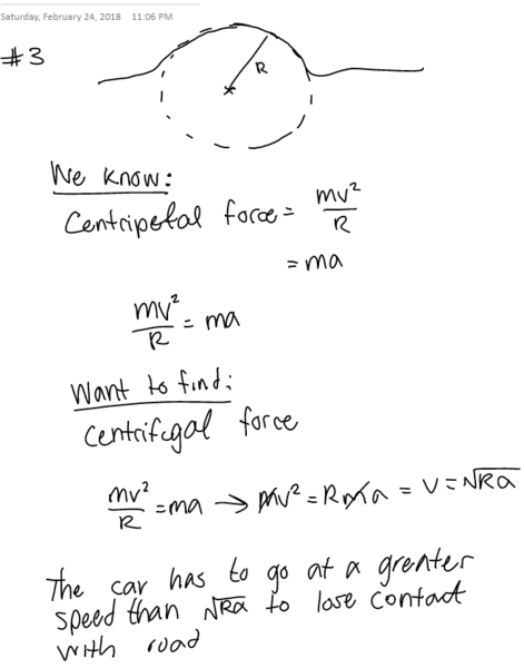

Find the speed at which a car of mass M will lose contact with the frictionless road
Centripetal/Centrifugal forces (maybe?)
I used OneNote to attempt this problem[/B]
https://onenote.com/webapp/pages?to...0EkvVRJz3ZRVraisuhYOUH0&id=636551577043927699
If there would be no friction between the road and the car (##\mu=0##), what force should keep the car on the curved path?
Centripetal force right? I was thinking that if the centrifugal force was bigger than the centripetal the car would veer off. Or is that incorrect, because centrifugal is fictitious?
That's correct, but without friction, where should the centripetal force come from?

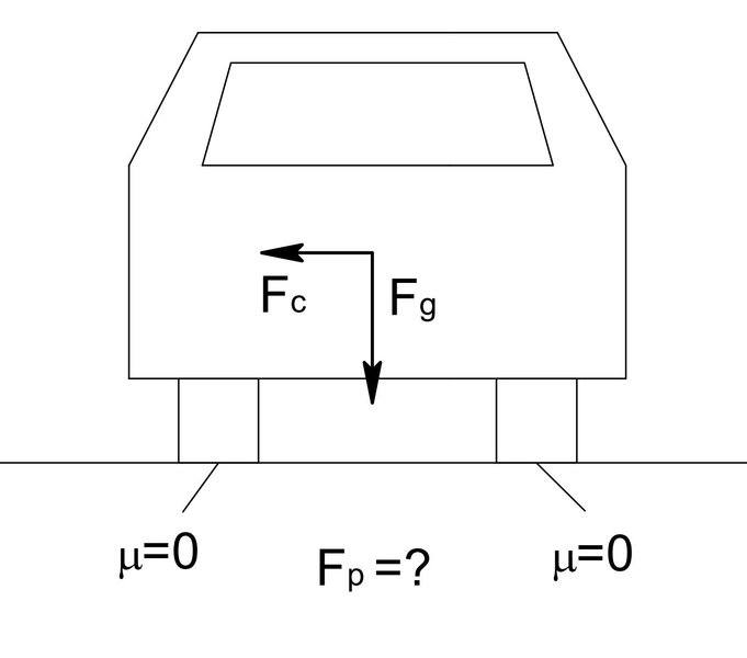

Looking at the image...I know that gravity is a type of centripetal force but what role does it play on car roads? I thought that velocity played a bigger part because the centripetal force is keeping the velocity circular
In the picture I posted, I just wanted to draw all acting forces (by neglecting the drag/air resistance). There is no force acting against the centrifugal force. Therefore the question must be different than you posted it or the answer is: At any velocity ##\neq 0##.

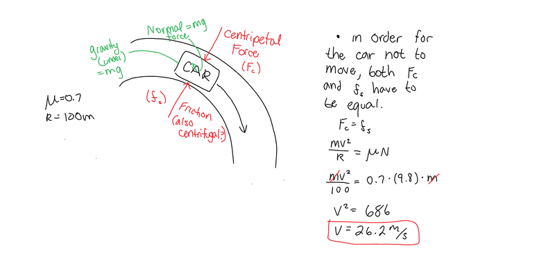

And yes, if there is no friction the driver is not able to follow any curve, as "flat" as it could be. However, I propose the following: For a dry street the coefficient of friction is about ##\mu=0.7##. What would be in this case the maximal velocity to keep the car on the curved path, assuming the radius of the curve is 100 m?

Thank you for giving me extra practice and help! Notice where I put the centrifugal (basically equal to friction), is that okay to do?
Thank you for taking it and well done!
PS.: I'm not sure, if I interpret your drawing correctly, but just to be sure: The centripetal force is the real one due to the real friction. The centrifugal force is felt only due to the inertia of the car, which is deviated from its linear and constant motion.

The drawing in the OP is unclear... Is the car going around a bend or over a hill?
Sorry, it's around a bend
OP's initial post #1 says the road is frictionless and the figure posted on onedot.com shows a banked road. It looks like the offered solutions and assistance are off the mark.
