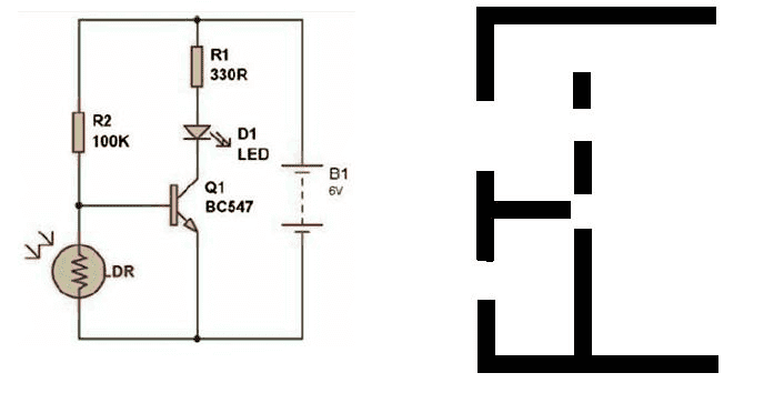

in it's very basic form, the circuit schematic can be directly translated to a PCB layout by making sure there are tracks that connect the same components to each other as shown in the schematic

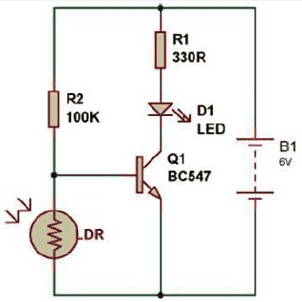

OK a basic circuit
a basic PCB for that schematic
you can clearly see where each component goes when comparing the circuit to the PCB layoutDave

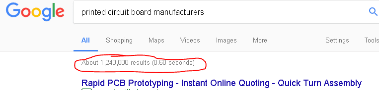

Thanks for sharing this article here. I need your help please. Hope you might know the source. I need PCB circuit board manufacturer. Where is this available. Actually I am looking for a reliable source.
I've used PCBExpress for simple prototypes. You design the board using their software and they mail it to you.
There are many many outfits in the PCB manufacturing business and a simple search will offer you a smorgasbord to choose from. Probably there's one near you.
