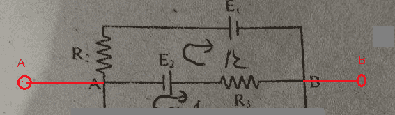

Circuit schematic with two batteries E1 and E2 and resistors R1, R2 and R3, with nodes A and B marked on the left and right of the middle branch.
R1 = 2 ohms
R2 = 4 ohms
R3 = 6 ohms
E1 = 10 V
E2 = 14 V
What is the voltage between point A and B ?
A. 0.18 V
B. 0.98 V
C. 1.34 V
D. 1.64 V
E. 3.28 V
KVL
[/B]
I tried using KVL
I assume that both mesh currents will go in clock-wise direction.
x = current goes in lower mesh
y = current goes in upper mesh
So, the current that goes through AB or I3 is (x-y)
For the lower mesh,
E2 - I3R3 - x R1
14 - 6(x-y)-2x = 0
For the upper mesh,
4y - 10 - 6 (y-x) - 14 = 0
Solve for x and y..
x = 5.8 A
y = 5.4 A
So, the current goes through AB is 0.4 A
So,
Vb = 14 - 6 (0.4) = 11.6 V
Va = 11.6 - 2(5.8) = 0 V
So, I think Vab = Va - Vb = -11.6 V
But, it's not in the option..
However, this is the book answer

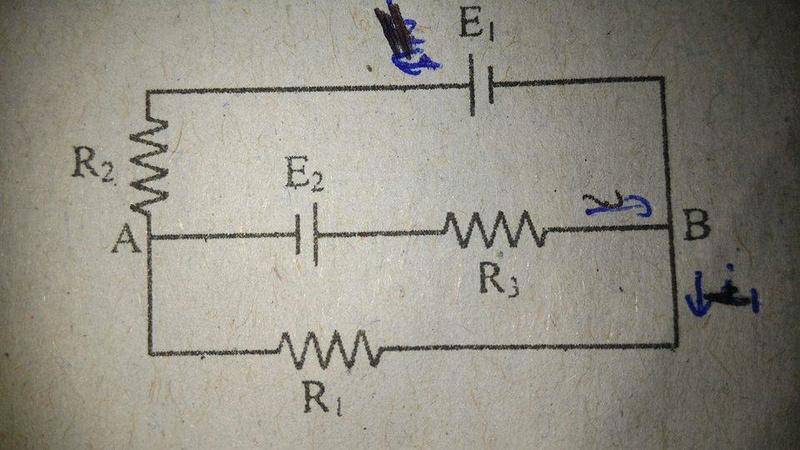

Handwritten circuit diagram with two loop currents, sources E1 and E2, resistors R1, R2 and R3 between nodes A and B, followed by worked formulas for E12, R23 and VAB giving 0.18 V.
I have no idea what methods are used to solve this very quickly.
Please help
You need to reconsider this equation.
Generally, it is easier if you wait with inserting values until you have the final expression. It makes it much easier to follow what you are doing.
What's wrong with that equation??
I'll update my first post
Try doing it again. Mark the direction of the assumed currents at each wire and follow the loops.
Alright. I try again.
For the lower mesh,
I start at point A and going clockwise
E2 - I3R3 - I1R1 = 0
E2 - (I1 - I2) R3 - I1R1 = 0
14 - 6 (I1 - I2) - 2 I1 = 0For the upper mesh,
I also start at point A and going clockwise
- I2R2 - E1 - (I2 - I1)R3 - E2 = 0
- 4 I2 - 10 - 6 (I2 - I1) - 14 = 0
(sorry, I made the mistake at this upper mesh equation)
Solving both equation :
I1 = -0.0909 A
I2 = -2.4545 A
which means that both current goes in counter-clockwise direction, right ? (since I assumed the currents are in clockwise)
I3 = I1-I2 = 2.3636 A
Vab = Vb- Va = I1R11 = 0.0909 A * 2 ohms = 0.1818 V
Thanks for help!

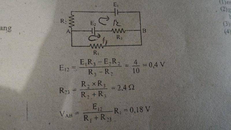

Anyway, what's the name of method my book using? It's so simple and I'd like to learn about it.
Indeed, using calculator is not allowed in the test so I need to know better methods to solve this.
It is Thevenin's theorem. The upper part of the circuit between A and B (with R1 removed) is replaced with a voltage source with emf equal to the open-circuit voltage between A and B and the equivalent resistance RAB, when the sources are replaced with shorts.

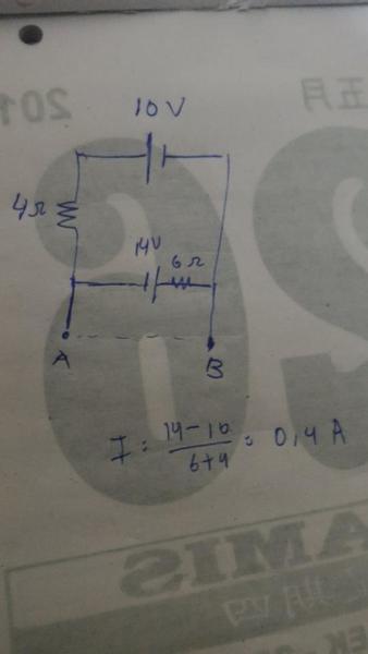

View attachment 101347Determine the voltage Uo between A and B. That will be the emf of the Thevenin-equivalent voltage source. The internal resistance of the source is obtained if you connect A and B with a zero ohm wire and determine the current Is flowing through that "short". The internal resistance is Ri=Uo/Is. But it is the same as the equivalent resistance between A and B if you replace the batteries by shorts, (simple wires). When you know the emf and internal resistance of the Thevenin-equivalent source, you need connect the resistor R1 to its terminals, and find the voltage across it.
Handwritten circuit diagram with a 10 V source and 4 Ω resistor in the upper loop, a 14 V source and 6 Ω resistor in the lower branch, terminals A and B, and the calculation I = (14 - 10)/(6 + 4) = 0.4 A.
Alright, This is what I've done.
I just know how to find the current that loops through the upper part.
But, I don't know how to find the emf (Thevenin-voltage). Please help
EDIT : I made a mistake
The current should be 10+14/(4+6) = 2.4 A
Yes, it is the current that flows through the resistors, anti-clockwise. Consider the potential zero at A. What is the potential at B?
Since the current goes anti-clockwise, I think there will be potential rise across the 14V E2 and potential drop across 6 ohms resistor.
So, the potential will be = 14 - 2.4 * 6 = -0.4 V, right?

Why the book approach in finding the Thevenin emf is just (E1 R3 - E2R2)/(E3-R2)? It seems like a mean(average-value), but why it substracts?
Both E1 and E2 are running currents in the same direction (anti-clockwise), but why it substracts in the book approach? Or, is there a theorem about this?

That looks good!
But, I'm still confused about one thing.
The problem asks about the potential between point A and B.
Why the answer is not 0.4 V which is the potential difference between point A and B ?
Why we instead find the potential across R1 resistor ??
Don't forget about the Thevenin resistor in series with the v0.4V source.

Why the book approach in finding the Thevenin emf is just (E1 R3 - E2R2)/(R3 + R2)? It seems like a mean(average-value), but why it substracts?
Please help
Slight typo (corrected in red.)
In relation to points A and B, E1 and E2 are in opposite directions.

You would get the same formula if you did the derivation symbolically. I=(E1+E2)/(R3+R2) , UAB=E1-R2I or UAB=R3I-E2. Bring to common denominator and simplify.

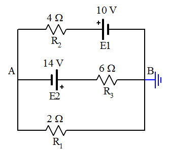

Have you considered applying nodal analysis (KCL) rather than loop analysis?
A very quick solution can be obtained if you apply nodal analysis. If you choose the reference node to be B then A is the only essential node. That means you can solve for the potential at A with respect to B using a single node equation.
##\frac{V_b-E_1}{R_2} = \frac{V_b-E_2}{R_3+R_1} \\
\frac{(V_b-10)}{4} = \frac{(V_b-14)}{8}##
But, I get ##V_b## equals to 6 V.
Sorry, I'm bad at nodal analysis. Please help
There are three branches between nodes A and B (Don't forget the R1 branch!), so your equation will contain three terms, one for each branch leaving node A. Re-drawing your circuit to show the reference node as B:
Circuit diagram with nodes A and B joined by three parallel branches: top branch 4 Ω resistor R2 with 10 V battery E1, middle branch 14 V battery E2 with 6 Ω resistor R3, bottom branch 2 Ω resistor R1.
You want to find the potential at node A. Write your equation in the form ##\sum ~ I = 0##.
