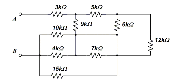

For the circuit shown below, find the R equivalent resistance between terminals A and B.
http://puu.sh/bX1Sp/33db39d1c0.png
parallel and series circuit definition[/B]
I admit that I don't even know where to begin with this question...
Can someone give me a hint??
[/B]
You were give a question to solve without being presented with the basic theory and examples in your course or text?
Hint: There are several opportunities to combine parallel resistances. There's also a resistor that's completely shorted out. Look for them and make a start.
