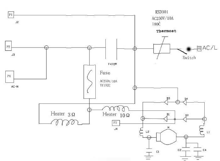

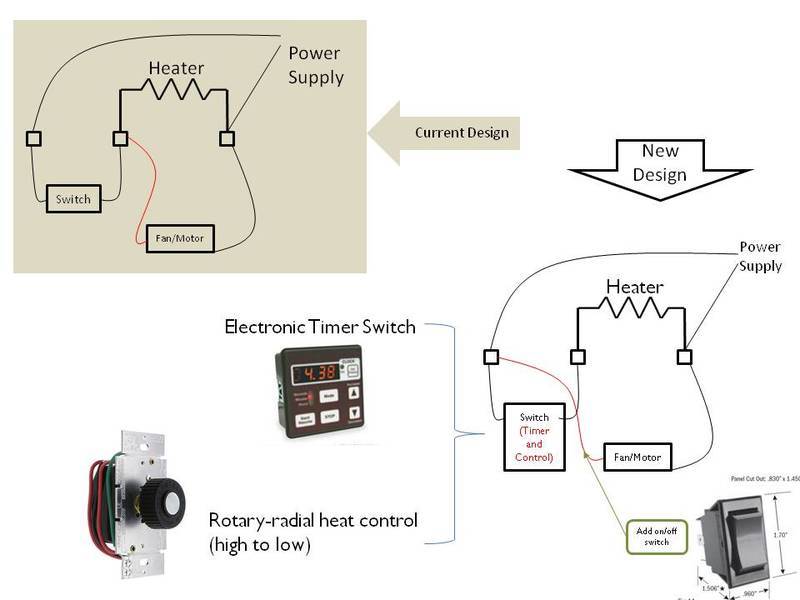

Hi there!
I recently tried adding an on-off switch, a timer and a control dial (like a dimmer switch for the heating coil) to my unit. See diagrams attached. I also rewired a fan wire.
Instead of the complicated circuit diagram (see first attachment), I have shown the equipment wiring in a simpler diagram (see second attached).
I don't really know how to update and add these three things or rewire the wire to the circuit (the first attachment) i.e. where to put the switches and dimmers/which wire to rewire according to the changes etc. I am not an engineer but a design enthusiast- I want to be an industrial designer and I was playing around with features.
Any help on adding the few items to the first circuit accordingly will be greatly appreciated!
Thanks so much!

If you haven't had any training in basic electronics and circuits, the I highly recommend you take a class or at least buy a book or two on the subject. Attempting to rewire electronic devices can be extremely dangerous and you need to understand what and why you are doing something, not just have someone tell you how to do it.
It should be like this,but I will suggest don't do unless you are sure what you are doing.I guess its powered by main i.e.. 120/220 VAC and that is dangerous buddy... their are many safety precautions we take before working on AC mains.
Their are many details you will need before attempting that,most important the power rating of your device and the new circuit components you are going to add,like the heater control and timer control you showed in your pic ,does they have enough capacity (power rating given in watts) to handle the heater as heaters use a lot of power it can burn your heater control and timer control if the power capacity exceeds even may cause fire in some cases.
Don't do that if you are not sure.
Good Luck

That is just as bad, do you not realize. As a designer, your liability extends to the safety of third parties, be it fabricators or users.
Doesn't the timer need to be in series with the heat control unit if it is to control ONLY the heating element?
Correct.
You wern't very clear in the original post on what you wanted the circuit to actually do.
PS: Your own attempt was potentially dangerous because it allowed the heater to be turned on without the fan running. That could potentially allow the unit to overheat, catch fire etc.
If you have access to an electrician you are better off explaining to him the functionality you want to achieve and letting him draw the circuit.

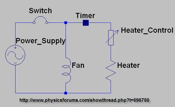

Well in your circuit diagram the (second one look at the current design) the fan is connected parallel with the heater,what will happen if you connect the fan before the timer is ,the fan will keep running whenever the unit is switched on.
Your design says that it controls BOTH the fan and heat. Is that correct?
Yes
How is the red wire (attachment-2nd diagram) changed/rewired.
Red wires are used for phase in electric wiring,but unless we see we can't say much...

Thanks for the updates, the unit needs the fan to be on when the switch is flicked on. Then the timer decides how much time the heater is going to run, and on what setting (that is what the heat control dial is for).
All I wanted to know was where exactly the timer and dial/control went in the circuit.
This is what you are talking,assuming you have verified all the components that will work with your system.
Good luck

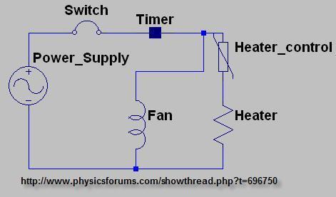

Your circuit is very much appreciated! Please, if you would kindly...look at the attached circuit which is the appliances (coffee roaster). Courtesy of CWatters.
The M in this diagram is the fan in yours, and the 10 ohm resistor is the heater. The AC/L is the power power source with the switch next to it. Disregard the other components, and bridge rectifier. Given this circuit explanation, where should the timer and heat control be situated? I'm thinking between the 3ohm R and 10ohm R (in series)?! Please let me know if you have a moment.
Thanks again for all your help!

Well again your circuit diagram is not very clear (and that circuit might not work, unless I get the values of the components I can't be sure) ,I can't understand it properly unless you give the proper diagram with every component and their proper data parameters.What's that 3 ohms resistor, is it a heater why you are connecting two heaters and no the timer and heater control shouldn't be connected between 3 ohms and 10 ohms resistors.
Good Luck

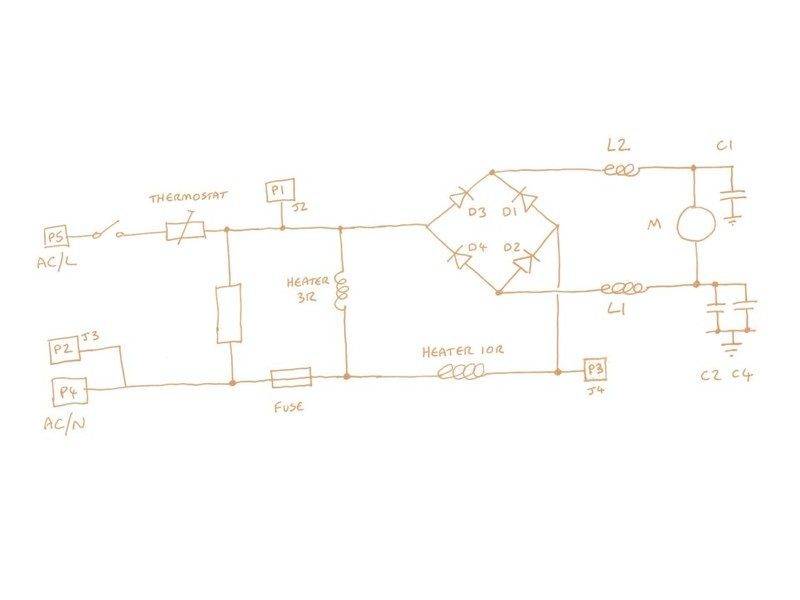

Attached is the model diagram to help clarify the appliance circuit (See first page).
1. The Button (#6 on picture) is the switch, power cord (#7) is the AC/L power source.
2.`Heating wires (#22) is the two resistors/heating coil.
3. The fan/motor (#32) and the 4 diode bridge rectifier is (#33)
5. The fuse is #25 and the thermostat is #11.
The miscellaneous resistors and inductors are not shown with values, but I can get them to you very soon. Please kindly let me know if they are of any help. :)

Well I didnt have to analysis the complete circuit,to tell the circuit in the schematic is not going to work ,look at the motor's connection ,both the sides of the motor is connected to positive side of 9 V DC i.e.. across the motor you have 0V (9V - 9V = 0V) use Kirchoff's voltage law.
May be you did some mistake with the schematic,if its a working product as CWatters.
It seems your knowledge at this time is somehow limited on electronic/electrical ,I suggest you to study a bit more before you could successfully explain your designs to others,their are many electronic forums where you could get help from.
And its safe to work/modify this device at some extend as it is not a high voltage device, most electronic forum will accept it.

Well I already answered your that question check my earlier post ,but anyway I am doing it again look at the circuit ,the 3 ohms heater is connected to directly to AC mains and the 10 ohms heater is used in a fashion to drop voltage as per the motor voltage requirement(assuming the motors current is constant) ,a very bad circuit design, if their is increase in mains voltage their will be increase in motors voltage and current ,but for protection they provided RC circuit for the motor but that will be not much help at certain conditions.
The point is that where you could connect your heat control ,you can only connect it with the 3 ohms heater in series ,but in case of 10 ohms heater you can't as it is in series with motor if you change current in 10 ohms heater you also change current in motor i.e.. fan becomes fast and slow.If it becomes too slow the heater will heat too much and will be destroyed.
For the timer ,commercial timer units needs proper power supply ex.. 5VDC ,9VDC ,12VDC you have to provide it from external source and and they have a relay you need to connect this relay to the controlling unit in series like switch connection.Well you can connect it to 3 ohms heater but if you connect it to 10 ohms heater it will stop the motor ,if you don't it will only control 3 ohms heater and 10 ohms will always be working.
In short this circuit is not that flexible to be modified to something you imagined.
Now this circuit (above) is not safe to work its not isolated from mains and its a high voltage circuit ,so don't do it...
I don't see that.
The diodes appear to form a bridge rectifier with the motor between +ve and -ve.
@CWatters look at the pdf schematic,I was talking about that... both the input of the bridge is positive 9VDC
Ah OK. I think the OP explained they weren't meant to be batteries. I think this is the second thread on this subject.

Well I also think the pdf schematic doesn't make much sense,the first one does make sense and should work.
@sasg28
If you just need to add timer to the unit you can connect it from out side just buy a commercial timer unit power it with a suitable power source,and it will have relay ,you just need to connect the relay points.
And about adding heat control ,I think it shouldn't be done as coffee roasters/pop corn poppers needs a specific heat to work if you change that the unit may not work.
