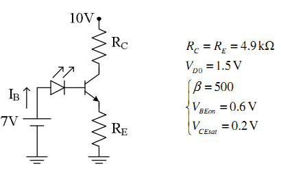

Find the base current of the following circuit
The solution to the problem is 4 micro amperes. Why? I get base current = 0 A because the transistor is satured and colector current=emissor current=1 mA

There are a lot of assumptions being made, including the assumption that the transistor is in saturation.
Suppose that you assume that it is not saturated, and that IC = β IB. What values do you calculate for IB and IC? How about VCE? Are the results self-consistent, or is saturation confirmed?
I have done the math since the beggining, I just want to know if the solution is wrong or not. If is not satured then ib= 2 micro Amperes and ic=998 micro Amperes. Colector voltage becomes 5,11 and Vce=0,21. It is in the active zone. solution is wrong right?

I agree with 2uA calculated as follows...
The base voltage is fixed at 5.5V so the emitter voltage will be 4.9V (cannot be lower than 4.9V).
Therefore
Ie = 4.9/4900 = 1mA
Ie = Ib + Ic
Ic = Ib * hfe
Ie = Ib + hfe*Ib
Ib = Ie/(1+hfe)
Substitute values
Ib = 1mA/501 = 2uA
Ic = Ie - Ib = 0.998mA
That gives a collector voltage of 5.11V. Not quite saturated.
On reflection I think it unlikely that the LED would drop 1.5V at 2uA. So the base voltage would be pulled higher and transistor probably would be saturated.
Will try and have another look at it.

Ok try this. Let's not assume the transistor is saturated for the moment. Let's replace the LED with an unknown resistor value Rb and assume Vce is unknown. Then I think you can write the following three KVL equations...
(Ib+Ic)*Re + Vce + (Ic*Rc) - 10V = 0
(Ib+Ic)*Re + Vbe + (Ib*Rb) -7V = 0
7V - (Ib*Rb) + Vbc + (Ic*Rc) = 0

I wasn't really suggesting you calculate a fixed value for the diode resistance. There is no need to. It should be possible to solve for Ib without actually calculating an equivalent value for Rd. I dissagree on Vd. You would not need to take the Vd=1.5V into account. My point was that the base current is so low that it's not valid to use a model that has a constant voltage drop.
If you substitite Ib*Rb with 1.5 V that means you have 5 equations and 4 unknowns. Is it possible that would give you multiple answers?
The transistor is most definitely saturated.
So to get the base current, use ie = ib + ic. If saturated, what is Vc? And therefore ic? And ie? And then the grand finale : ib?
Hint: ib is way, way bigger than 2 uA! And beta has nothing to do with the problem.

ie = (V - 2Vd)/Re = 5.5V/4.9K = 1.12 mA
ic = (10-5.5)/Rc = 4.5V/4.9K = 0.92 mA
ib = ie - ic = 1.12 - 0.92 = 0.20 mA
EDIT: I did not notice that the drop across the LED is 1.5V. That makes C Watter's analysis essentially correct. (I would assume Vbe = 0.7V rather than 0.5V).
There is about 0.4V headroom for Vce so the transistor is not in saturation and the use of beta = 500 is correct.
Sorry folks.
Q is saturated because the computation ic*Rc ~ ie*Rc = 5.5V which is > (10 - Ve) and so impossible.
I used Vbe = 0.6 as that's stated in the problem.
Personally I'm still undecided how best to answer the question..
If you take the question at face value and use 1.5V for the LED drop then the transistor is not quite in saturation and you get Ib=2uA
However i think the LED drop is unlikely to be 1.5V at 2uA in which case Ib is likely to be higher. See my post #10 for a way to calculate Ib in that case.

I agree, 1.5V for an LED runing only 2 uA is unlikely. For another thing, no way is it putting out visible light.
Per the OP's post the 'official' answer is 4 uA.
I have shown how to compute ib if the transistor is saturated in my previous post, wherein I assumed a drop of 0.8V for the LED (1.5V total LED plus Vbe).
