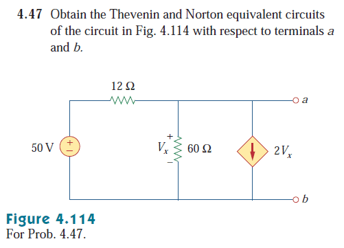

Circuit schematic: 50 V source in series with a 12 Ω resistor, feeding a node with a 60 Ω resistor to ground and a dependent current source labeled 2Vx, with control voltage Vx across the 60 Ω resistor; terminals a and b at right.
Attached to this post. I'm not sure how to proceed.
  • Handwritten circuit schematic with a 50 V source, a 12 Ω resistor, a 60 Ω resistor to ground with voltage Vx, a dependent current source 2Vx, loop currents i1, i2, i3, terminals a and b with current IN, and mesh equations below.

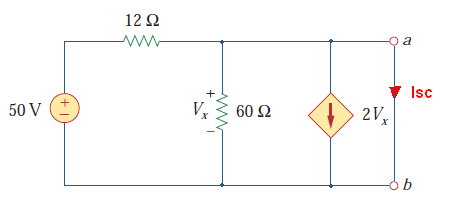

First try to write one nodal equation for only one unknown nodal voltage Vx = Va = Vth.
Next, short point A and B and find this short circuit current Isc. And from there
Vth = Vx = Va and Rth = Vth/Isc
  • Circuit schematic with a 50 V voltage source in series with a 12 Ω resistor feeding a node Vx across a 60 Ω resistor, with a dependent current source 2Vx between terminals a and b and the short-circuit current Isc labeled flowing from a to b.

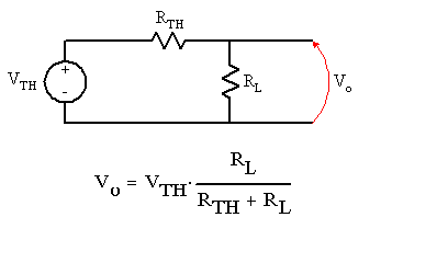

Here's a hint that might help.
If you consider a general Thevenin model with a resistive load attached, you've really got a simple voltage divider:
Circuit schematic of a Thevenin equivalent with load: voltage source VTH in series with resistor RTH, feeding a load resistor RL across the output terminals labelled Vo, with the equation Vo = VTH times RL over (RTH + RL) below.
If you were to tack a load resistor onto the output of your circuit and use node voltage analysis to solve for the output voltage, then you should be able to rearrange the resulting expression into the form of the voltage divider expression and just pick out Vth and Rth by inspection, thus solving for both at the same time.
This technique can be very handy; as long as the circuit in question has at least one power source (so any controlled sources can be "stimulated"), you don't have to bother with sticking external sources onto the output to find resistances or voltages.
  • Circuit schematic of a Thevenin equivalent with load: voltage source VTH in series with resistor RTH feeding a load resistor RL, output voltage Vo taken across RL, with the formula Vo = VTH times RL divided by (RTH + RL) below.
Sorry, I wasn't clear enough in my original question. I'm not sure how I forgot put these details but here they are now. I've calculated the Thevenin equivalent and I'm currently trying to get the Norton equivalent. I realize that I can just use source transformation to convert from the Thevenin equivalent to the Norton equivalent but I am trying to get the Norton equivalent directly from the circuit.
Since I already did the Thevenin equivalent, I already know that Vx=10/21 V and Rth=10/21 Ω. Now, I'm trying to calculate IN. I've connected nodes a and b but I am having trouble applying mesh analysis. I've already applied mesh analysis to mesh 1 but after looking at it, it seems to be incorrect. Here is the correct mesh analysis:
$$-50+12{ i }_{ 1 }+60({ i }_{ 1 }-{ i }_{ 2 })=0\\ -50+12{ i }_{ 1 }+\frac { 10 }{ 21 } =0$$
Edit: Actually, I don't even know what Vx is. That was incorrect.
I've tried applying nodal analysis at node X:
$$\frac { { v }_{ x }-50 }{ 12 } +\frac { { V }_{ x } }{ 60 } +2{ V }_{ x }+{ I }_{ N }=0$$
but I'm still stuck.
Instead of nodal analysis, first redraw your circuit with the short circuit in place. A whole bunch of things get "squashed" by this short circuit. For example, what would Vx be?
Hmmm, Vx would be 0V, right? And that means I can remove the 60 ohm resistor and the dependent current source, right?
Try it and see :smile:
Your results should match your Thevenin values via the simple transformation.
Haha, I got it. Wow, I was stressing out over such a simple problem.
