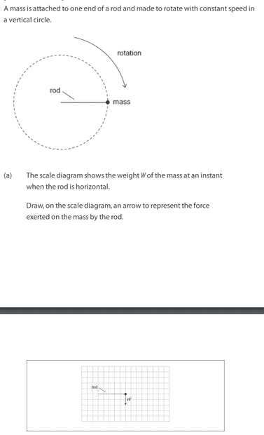

A mass is attached to the one end of a rod and made to rotate with constant speed in a vertical circle.
Free Body Diagram
By looking at the following question, I have no idea why the direction of force exerted by rod on a ball is represented like that. can anyone help me to understand?
Like what? The only force I see represented is the weight of the ball. You are asked to add a representation of the force from the rod.
sorry for the confusion, you are supposed to draw a force exerted on the mass by the rod. not the "W"
Have faith in Newton's laws! In particular, ##\vec F = m \vec a##
What is the direction of the acceleration of the mass?
