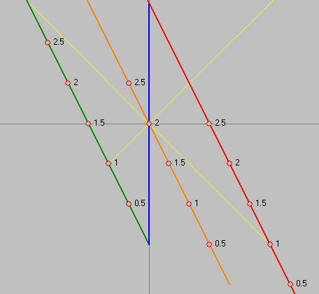

Here's the space-time diagram off this according to Jill's frame. The orange line is Jill's world line, the Blue is Jack's world line and the world lines for the clocks are the green and red lines. The yellow diagonals represent the light seen by the camera if the picture is taken when Jack and Jill pass each other. the picture will show both clocks reading 1. Jill will also conclude that, at the moment the picture is taken, both clocks read 2.
Here is the same scenario according to Jack's rest frame:
Notice that the same light carrying the same image of each clock also meets up with Jack;s camera at the moment Jack and Jill pass each other and Jack takes his picture. Thus his picture will also record both clocks reading 1. However, the light from each clock that forms the picture left each clock at different moments by his clock and when the clocks were at different distances from him. Also, according to him, at the moment the picture is taken, the two clocks do not read the same as each other or Jill's clock. Jill's clock reads 2, while one of the clocks only reads 1.5 and the other already reads 2.5.

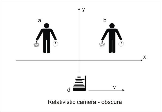

Just for clarification:
We consider that pinhole camera (obscura) takes picture of two clocks, that are attached to the ends of relativistic train. The train moves in dark space. At certain moment we highlight these clocks by short flashes. EDIT: These two flashes are in immediate vicinity to the clocks. We launch these flashes simultaneously in train's frame.
There are two cameras: one is at rest in the reference frame of the train, at equal distance from the clocks on the ends, and at distance y from the center.
There is another relatively moving camera. Its coordinate at Y axis is y also. Both cameras take picture when their spatial positions coincide, when center of the train and apertures are at points of closest approach.
We agree, that beams of light simultaneously come to apertures of these cameras and readings of the clocks will be the same on the both pictures. We agree, that the clocks will show the same time on the pictures.
What about distance between clocks at the pictures? Will it be the same in both cases, at picture taken by that camera "at rest" and that one "in motion"?

@Janus means, that readings of the clocks will be the same at the both pictures, if cameras are co-located. Two clocks will show the same time. No doubt.
If certain camera is at rest in the reference frame of the train, image will not be distorted, it is obvious,
But, picture taken by moving camera will be distorted because of Lorentz contraction at least. The problem is, how exactly these distortions will appear on the picture.
https://en.wikipedia.org/wiki/Length_contraction
"Length contraction is the phenomenon of a decrease in length of an object as measured by an observer who is traveling at any non-zero velocity to the object“
Image will be Lorentz –contracted, won‘t it?

We can also consider two twins at certain distance from each other. Each has a clock and a flash. They launch flashes simultaneously. We want to know what will be distance between twins at picture taken by camera at rest and one in motion, when the center between twins and apertures at points of closest approach.
The beams will simultaneously go through aperture and simultaneously hit the film.
Patches of rays from flashes to aperture and from aperture to film form two similar triangles, in moving camera and in that one at rest.
Let’s we take a picture of a flat square, at each corner of the square we attach a flash. We launch flashes simultaneously in square’s frame. Centroid is in the origin. Aperture comes to point y at the same moment, when beams simultaneously come to point y. Then the beams go through aperture simultaneously hit the film.
After visualization we will see four bright dots on the film. Image will be shifted a bit from the center. But square will turn into rectangle on the picture.
By aspect ratio (vertical vs horizontal) we can measure magnitude of contraction
By the way. In Terrell's paper sphere moves in camera's frame, not vice versa.
The problem is (as I see it) - who contracts? Train? Distance between twins? Or film in the camera?

To answer this, let's look at another set of space-time diagrams.
Here will will assume that Jack has his own identical train which is at rest with respect to the tracks. Each world-line in these diagrams are separated by 1 "train car length" as measured in each rest frame.
First we have Jill's frame.
The flashes leave the clocks at simultaneously from a distance of 5 her train cars from Jill. Note when the flash leaves the right clock it is just a bit shy of 3 of Jack's train car lengths from Jack and when the flash leave the left clock, that clock is between the 8th and 9th od Jack's train car lengths. Thus is one direction, she will see ~3 of Jack's train cars stretched out over a distance of 5 of hers and in the other a over 8 of Jack's train cars compressed over a distance of five of hers. This puts a bit over 11 of Jack's train cars that fit between a 10 train car distance for Jill.
Now consider Jack's frame
Here we see that The flashes do not leave simultaneously. However the right flash still leaves while 5 of Jill's train cars from Jill, and a bit less than 3 of Jack's train cars from Jack, while the left flash leaves 5 of Jill train cars from Jill and over 8 of Jack's train cars from Jack. This means that in Jack's photo, the right clock will appear to less than 3 train cars away while the left clock will appear to be over 8 train cars away, and the distance between the clocks will be a bit over 11 train cars apart. To the right he will see 5 of Jill's train cars compressed into a distance of 3 of his, and to the left he will see 5 of Jill's cars stretched out over a distance of better than 8 of his. This of course doesn't directly tell him how far apart the clocks are as measured in his frame, because the light from each clock left at different times. Between the time a flash left the left clock and one left the right clock, the right clock had moved relative to Jack. To get a picture that shows how far apart the clocks are in his frame, the flashes would have to leave the clocks at the same time in his frame. In which case he would see the 10 of Jill's train cars contracted to fit into a distance taken up by 8.66 of his train cars.
Janus said:
This puts a bit over 11 of Jack's train cars that fit between a 10 train car distance for Jill...Now consider Jack's frame
and the distance between the clocks will be a bit over 11 train cars apart. ... To get a picture that shows how far apart the clocks are in his frame, the flashes would have to leave the clocks at the same time in his frame. In which case he would see the 10 of Jill's train cars contracted to fit into a distance taken up by 8.66 of his train cars.
Thank you very much for your diagrams and your answer. I agree.
That means, that if flashes work simultaneously in train’s frame, on the picture taken by Jack (who is moving with camera) the train appears gamma times stretched and the clocks show the same time.

We can also consider these pictures this way:
Imagine that observers ##A## and ##B## with synchronous clocks (in the Einsteinian sense) are located at points ##a## and ##b## on the ##X## -axis of the coordinate system ##K## symmetrically about the point of origin ##O##. The coordinates of points ##a## and ##b## are, respectively, equal to ##-x## and ##x##. On the ##Y## -axis at point ##d## with the coordinate ##y## there is a camera obscura with its opening directed to the point of origin ##O##. Observers ##A## and ##B##, who are in range of vision the camera obscura, wish to take their simultaneous photos. To do so, each of them at a point of time ##t=0## activates the flash. The distance from each observer to point ##d## is equal to ##\sqrt{x^2+y^2}##. Therefore, after a time equal to ##\sqrt{x^2+y^2}/c##., the light pulses reflected from the observers simultaneously fall into the opening of the camera obscura, and this pair of observers ##A## and ##B## is captured on the film. The photo is not distorted. The height of the observers, their cross-sectional dimensions and the distance between them on the photo are proportional to their actual size.
image hosting without registration
Now imagine that the camera obscura is not at rest at point ##d##, but moving parallel to the ##X##-axis with velocity ##v##, getting to point ##d## at the moment of time to ##\sqrt{x^2+y^2}/c##. The light reflected from the observers, which at this time has simultaneously come to point ##d##, falls into the aperture of the moving camera obscura, and instantly falls on the film, thus producing an image. We believe that the dimensions of the camera obscura in the direction transverse to its motion are small enough and in the direction of its motion are large enough for the film not to go beyond the incident image falling on the film during the light travel period from the aperture to the film.
What kind of distortions appear in the photos and why?
Because of the reduction of the film moving in the coordinate system ##K## the image obtained after visualisation will be stretched in the transverse direction (in the direction of motion) ##1/\sqrt{1-v^2/c^2}## times. The figures of the observers will thicken, and the distance between them will increase. If on the photo one could see the clocks on the observers' hands or close to them, these clocks will show the same time, i.e. that the observers' wish to be photographed at the same moment in time would be fulfilled.
Yet the observers within the reference frame ##K'## where the camera obscura is at rest and where the observers ##A## and ##B## are moving, will think that the photo is "wrong".
They will assume that the flashes were activated asynchronously and asymmetrically to the place of exposure from the points located at different distances from the place of exposure. From their point of view, the light pulses, having simultaneously passed the aperture of the camera obscura at different angles to the plane of the film, did not simultaneously fall on the film and formed the image not at the moment in time ##t’##, but during period of time ##\Delta t’##.
Let's assume now that in order to obtain a "correct" picture though not satisfying the customers, the observers A and B, the observers within the reference frame ##K’## will activate the flashes simultaneously at the moment in time ##t’##, such that the pulses reflected from the observers ##A## and ##B## moving within the reference frame ##K'## will simultaneously arrive at the aperture of the camera obscura. As the distance between the observers and their transverse dimensions are ##1/\sqrt{1-v^2/c^2}## times less than their proper distance and dimensions, the image on the film becomes contracted, so the observers ##A## and ##B## on the photo become "thinner" and the distance between them becomes less. The clocks located close to the observers will show different time, i.e. the observers' wish to be photographed at the same moment in time would not be fulfilled.
The observers within the reference frame ##K##, wherein the camera obscura is moving, will assume that the light coming from the flash was emitted asynchronously and asymmetrically in relation to the place of exposure from points located at different distances from the place of exposure. They will assume that the light pulses, having simultaneously passed the aperture of the camera obscura, fell on the film asynchronously and formed the image not at the moment in time ##t##, but during period of time ##\Delta t##
According to said above, is this statement correct? Length contraction is the phenomenon of a decrease in length of an object as measured by an observer who is traveling at any non-zero velocity relative to the object." https://en.wikipedia.org/wiki/Length_contraction.
Also, which picture is the correct one? Does Jack's picture have physical sense? I think it does, because:
Readings of the clocks on the ends of moving train are always different. The rays went through aperture simultaneously. But on the picture readings are the same. Hence, I have taken a picture of Jill's train which is “at rest”. But, we are in a state of relative motion. Thus, I with my photo camera move myself. Since I and my film in the camera contract ourselves. Since film in photo camera contracts, Jill's train appears stretched after visualization. All that means, that I was in a state of relative motion to Jill and took a picture of her train “at rest”.
Do you agree with that?
