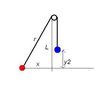

TSny said:
Let ##r## be the length of the string on the left and ##s## be the length of the string on the right. Let’s take downward as the positive y-direction for both A and B. The 2nd law is
##\sum{F_{A,y}} = M a_{A,y}## and ##\sum{F_{B,y}} = M a_{B,y}##
Then ##a_{A,y} = \ddot{r} - \frac{v_A^2}{r^2} ##. No assumption is being made about whether or not ##\ddot{r}## is a positive or negative quantity. Solving the equations will determine the value of ##\ddot{r}##.
##a_{B,y} = \ddot{s}##. No assumption is being made about whether or not ##\ddot{s}## is positive or negative. But ##a_{B,y}## and ## \ddot{s}## must have the same sign if positive y is downward.
We have the constraint that ##r + s## = const. So, ##\ddot{r} =-\ddot{s}##. Or, ##\ddot{r} =-a_{B,y}##.
So, the 2nd law equations are
##Mg-T = M \left (-a_{B,y} - \frac{v_A^2}{r^2} \right )## and ##Mg-T = Ma_{B,y}##
Solving gives ##a_{B,y} = -\frac{v_A^2}{2r^2} = -\frac{g}{18}##. So, B accelerates upward at g/18.

ehild said:
The centripetal force is MU2/L=T-Mg.
It seems to me that the assumption ##r + s## = constant is generally made for these idealized problems. ##r## is the length of the string on the left side of the pulley and ##s## is the length on the right side. Then ##\ddot{r} = -\ddot{s} = a_B##, where ##a_B## is the upward acceleration of B.
So, at any instant when B has a nonzero acceleration, ##\ddot{r} \neq 0##. But, ##\ddot{r}## is part of the acceleration of A.
So, it seems to me that we must have ##M \left (U^2/L - \ddot{r} \right) = T - Mg##.
That is, ##M \left (U^2/L - a_B \right) = T - Mg## instead of ##M U^2/L = T - Mg##

  • #38
Let ##r## be the length of the vertical string between the pulley and mass A. The point of disagreement seems to be with how one answers the following questions.
(1) If block B has an upward acceleration just after the collision, then does that mean that ##\ddot{r} \neq 0## at the same instant of time? If not, why not? If so, then proceed to question (2).
(2) Since ##\ddot{r} \neq 0##, then doesn’t that mean that ##\ddot{r}## should contribute to the acceleration of mass A? If not, why not? If so, then proceed to question (3).
(3). [Edited to correct typo] If ##\ddot{r}## contributes to the acceleration of A, then doesn’t that mean that the acceleration of A just after the collision is ##v^2/r - \ddot{r}## rather than just ##v^2/r##? If not, why not?
It seems odd to me to allow the effect of the velocity of A to be transmitted essentially instantaneously by the string to B (and causing B to accelerate) while not allowing the effect of the acceleration of B to be transmitted essentially instantaneously back to A.

The equations I obtained for time zero were:
Radial Force Balance from upper pulley to mass A:
$$T-mg=m\left[r\left(\frac{dθ}{dt}\right)^2-\frac{d^2r}{dt^2}\right]$$
where r is the distance between the upper pulley and mass A, θ is the angle that the rope segment from the upper pulley to mass A makes with the vertical, and T is the tension in the upper rope.
Vertical Force Balance on mass B:
$$T = mg+m\frac{d^2r}{dt^2}$$
If we combine these equations, we get:
$$\frac{d^2r}{dt^2}=r\left(\frac{dθ}{dt}\right)^2-\frac{d^2r}{dt^2}$$
Solving for ##d^2r/dt^2##, we obtain:
$$\frac{d^2r}{dt^2}=\frac{r}{2}\left(\frac{dθ}{dt}\right)^2=\frac{v^2}{2r}$$
In my judgement, this confirms TSny's g/18 result.

Assuming A moves horizontally with speed u. With TSny notation, r he length of the left piece of the rope changes as ##r=\sqrt{L^2+(ut)^2}##.
If t=0, the rate of change is zero, and the acceleration is ##\ddot r = \frac{u^2}{L }##. It implies that the second derivative of the right piece is the negative of it, ## \ddot s = - \frac{u^2}{L } = a_B##.

  • #47
It seems to me that your expression for ##r## as a function of time is equivalent to treating A as moving along a horizontal line with constant speed just after the collision. Thus, A would have zero vertical component of acceleration. Another way to see this is to use the standard expression for radial acceleration in polar coordinates to write ##a_{A,y} = r \dot{\theta}^2 - \ddot{r}## where y is taken as positive upward. According to your result, ##\ddot{r} = \frac{u^2}{L }##. Therefore, ##a_{A,y} = r \dot{\theta}^2 - \ddot{r} = \frac{u^2}{L } - \frac{u^2}{L } = 0##.
But if ##a_{A,y} = 0##, then ##T-Mg = Ma_{A,y} = 0##. So, ##T-Mg = 0## for A. But then ##T-Mg = 0## also for B if we assume the tension is the same throughout the string. Therefore the net force on B is zero and B would have zero acceleration, which is not consistent with ##a_B = \ddot{r}##

Why an horizontal acceleration on A makes vertical acceleration on B at t=0 ?
This is a multiple choice task and must be answered by few or non calculations.
  • #59
Because it is not a horizontal acceleration on A, but a horizontal velocity given to A at t=0, which gives A a centripetal acceleration.
  • #60
See figure. If A travels horizontally, the left piece of the string gets longer, so the vertical piece has to shorten by the same amount. You can get the vertical acceleration of B ## \ddot y_2 = \ddot r ## in terms of the horizontal velocity of A.
