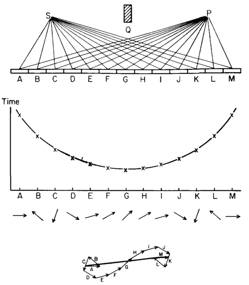

Richard Feynman's book QED The Strange Throery of Matter and Light used clever graphics to illustrate what the OP asks. At the very least, you see that if you simplify those little vectors to real numbers and add them up, you get the wrong answer. The vectors must have both magnitude and direction to get the right answer. That is what complex numbers do for us.
OP, if you want to learn more. I reccomend Feynman's book.
