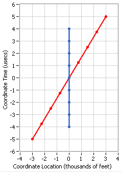

thrush said:
What I don't get is that for any event in frame S, where delta_X (and delta_Y, delta_Z) = 0, and only delta_T is non-zero, I am the guy standing on the train station watching the train pass.
OK, you've just described your worldline, the sequence of events marking off your Proper Time where you are standing stationary at the spatial origin of frame S. (Note that you haven't described any events for the passing train.)
thrush said:
Why then is the time in frame S', delta_t' never less than delta_t?
Presumably you intend for frame S' to be the rest frame of the train and the coordinates of the events that you have described are how your Proper Time is dilated in the train frame, that is, it takes more Coordinate Time to mark of an equivalent amount of your Proper Time.
thrush said:
It can't be because the denominator sqrt(1-B^2) can never be greater than 1!
Correct.
thrush said:
How can the passing train's time interval delta_t' be greater than the 'stationary' observer?
Because you are only stationary in frame S. In frame S' you are moving and your Proper Time is dilated. Remember, I said you didn't describe any events in frame S corresponding to the moving train. Or you could describe events for the stationary train in frame S' and transform them into frame S and then you would see that they would represent Time Dilation of the moving train.
thrush said:
I thought a velocity like β=3/5C would make delta_t' in the train's inertial reference frame always delta_t' < delta_t?

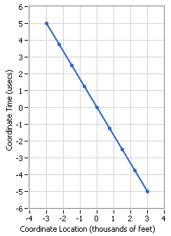

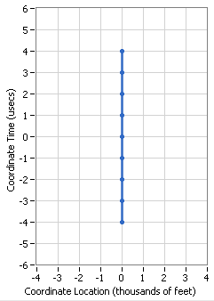

Yes, the events in your rest frame corresponding to your stationary position and marked off by delta_t are dilated when transformed into the train's rest frame and marked off by delta_t'. Let me add in a couple spacetime diagrams to depict what I have said. The first one is for frame S in which you are stationary at the spatial origin. I have only shown the plot going from 4 microseconds prior to the origin and 4 microseconds after:
Each blue dot represents one microsecond of time in the rest frame S and has coordinates of an event.
Now we transform all the coordinates of the blue dot events into a frame moving at 3/5c towards the right:
Now we see how you are depicted in the train frame: you are moving to the left and your time is dilated or stretched out compared to the Coordinate Time of the train frame.

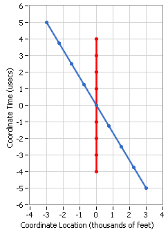

Now I want to add into the train's rest frame S' events corresponding to it being at the spatial origin of its frame. I'll show the train in red (you are still blue):
I think you can see that the train, at least the engineer's location, in his rest frame looks just like you did in your rest frame.
Now we transform all the events back into the original frame S:
And now we see what I think you originally expected to see of the train's time being dilated.
