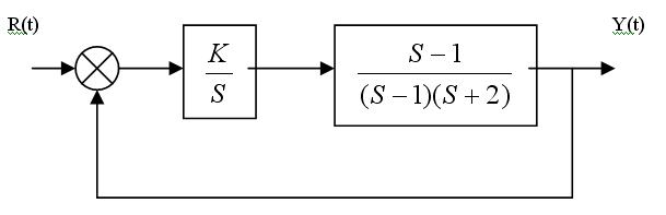

question:
find maximum velocity error constant(Kv)
feedback is :1 positive
the book says the right answer is:0.75
but every time i calculate E(s) it goes to the wrong answer!
please help!
Kv is K/2. The book's answer is correct if K = 1.5.
