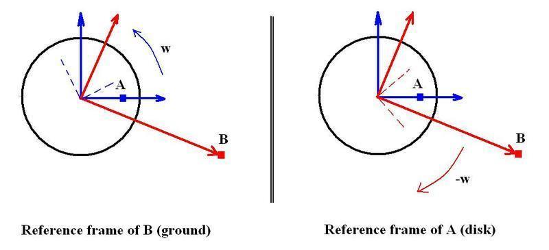

one more thing that i want to verify about the relative velocity calculation ... All I did to obtain this is to differentiate the position vector with respect to time so that:
[tex] \frac{d \vec{r}}{dt}=R \frac{d \hat{r}}{dt} = R \omega \hat{\theta} [/tex]
First of all, is true to get it that way (in all circumstances) ?
Is there another "physical", rather that mathematical, way to obtain this result? because frankly I can't imagine the picture that would lead me to this consequence of the realtive velocity.
When you differentiate the position vector or any vector w.r.t. time, you must state which reference frame you are considering.
_ In the reference frame of the ground or B, [tex]\vec{r}_B=const[/tex]. It doesn't change at all. So differentiate it w.r.t. time, you get zero, which is intuitive. But you will see that in this reference frame, A is moving, so [tex]d\vec{r}_A/dt\neq 0[/tex].
_ In the reference frame of the disk or A, you will A stays at rest, while B is moving in the opposite direction of the circular motion of A. So in this reference frame, [tex]\vec{r}_A=const[/tex] and [tex]d\vec{r}_B/dt\neq 0[/tex].
The motions of A and B can be described via the two coordinate systems sticking to A and B. For A, it's the red one, and for B, it's the blue one. The blue one sees the red one rotating (which corresponds to B's viewpoint), and reversely, the red one sees the blue one rotating in the opposite direction (A's viewpoint).
But then a problem of choosing the right sign for the angular velocity is raised...
because:
[tex] \frac{d \hat{r}}{dt} = \vec{\omega} \times \hat{r} [/tex]
so according to A, the angular velocity would be [tex]\vec{\omega}=-\omega \hat{z} [/tex] (the one which we substitute in the relative velocity equation), which has to be wrong because it won't give the final correct answer of the velocity ... In other words, which [tex]\vec{\omega}[/tex] need I choose and why?
Did you notice that I put a minus sign before [tex]\omega[/tex] in the picture? :wink: The rotations in the 2 frames obviously are in opposite directions.
EDIT: I didn't see your correction when posting. Your problem is that you use the notation [tex]\vec{\omega}[/tex] interchangeably between the 2 frames. If [tex]\vec{\omega}[/tex] is the angular velocity of A in the ground's frame, then the angular velocity of B in A's frame fortunately is [tex]\vec{\omega}_B=-\vec{\omega}[/tex]. Therefore, in A's frame:
[tex]\vec{v}_{rel}=d\vec{r}/dt = \vec{\omega}_B\times \vec{r}=-\vec{\omega}\times\vec{r}[/tex]
nono, I understand your picture ... what I mean is that the angular velocity that I used in the calculation of the relative velocity is [tex] \vec{\omega}=\omega \hat{z} [/tex] , however, for the expressions of the coriolis and centrifugal forces I used the opposite one, [tex] \vec{\omega} = -\omega \hat{z} [/tex] and it seemed correct because it produced the correct answer ... but, now, I'm not quite sure why different sign omegas are used, as one equation yields the other ... can u please clear for me this difference?
Okay. Let's make it clear:
_ The angular velocity of A in the ground's frame: [tex]\vec{\omega}_A=\vec{\omega}[/tex]
_ The angular velocity of B in A's frame: [tex]\vec{\omega}_B=-\vec{\omega}[/tex]
_ Relative velocity of B in A's frame: [tex]\vec{v}_{rel}=\vec{\omega}_B\times\vec{r}=-\vec{\omega}\times\vec{r}[/tex]
We have:
[tex]\vec{F}_{coriolis}=-2m\vec{\omega}_A\times\vec{v}_{rel}=2m\vec{\omega}\times(\vec{\omega}\times\vec{r})[/tex]
[tex]\vec{F}_{centrifugal}=-m\vec{\omega}_A\times(\vec{\omega}_A\times\vec{r})=-m\vec{\omega}\times(\vec{\omega}\times\vec{r})[/tex]
The total force on B in A's frame:
[tex]\vec{F}=\vec{F}_{coriolis}+\vec{F}_{centrifugal}=m\vec{\omega}\times(\vec{\omega}\times\vec{r})=-m\omega^2\vec{r}[/tex] which corresponds to the centripetal force.
Thanks pal! :wink:
