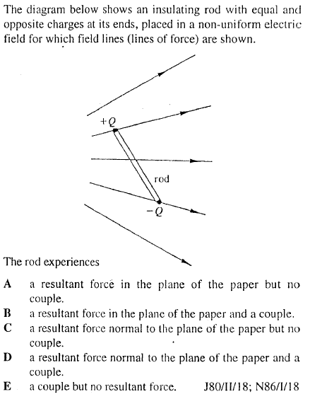

Couple on rod in electric field
The discussion revolves around the dynamics of a rod placed in a non-uniform electric field, specifically addressing the concepts of net force and torque. Participants clarify that the forces acting on the rod are unequal and not collinear, leading to a net force and torque about the mass center. The distinction between a couple and torque is emphasized, noting that a couple consists of two equal and opposite forces, which does not apply to this scenario. The net force can be represented as acting through the point of intersection of the forces, while the torque is determined by the unequal magnitudes of the forces. Overall, the complexity of the problem lies in understanding how these forces interact within the context of the electric field.
PhysicStud01
174
THe answer given is B.
I can understand why the resultant force is not zero as the field is not uniform. but for a couple, shouldn't the forces be equal. so how can B be correct?
also, at some point, the rod will be horizontal. won't the resultant force be non-zero and act horizontally while the torque is zero. the rod would stay horizontal?
can someone help if I'm misunderstanding something

The forces are certainly not equal. Where lines of force are closer together, the field is stronger.
However, I don't see an easy way to prove there is a couple about the mass centre of the rod.

You mean, back at the original question, right?
The question is not worded correctly.
The net of any system of forces acting on an object can be represented as the combination of a force through the mass centre and a couple.
If the force is nonzero then it is always possible to represent this pair by a single force that does not necessarily pass through the mass centre. Therefore the question ought to specify forces that act through the mass centre.
It is clear there is a net force because the two individual forces are not collinear. They are also different in magnitude, which is also enough in itself to ensure there is a net force.
There must be a net torque about the mass centre because the two forces act in the same sense about it. It follows that if the forces are represented as a force through the mass centre and a couple then the couple is nonzero.

First, let me correct one statement:
I was thinking only of 2D systems, as in this case. In general:
If the force is nonzero and the net torque is perpendicular to the net force then it is always possible to represent this pair by a single force that does not necessarily pass through the mass centre.​
E.g. if we consider two equal forces at right angles but not passing through a common point, the resultant linear force and the resultant torque are parallel.
You asked me to elaborate on this:
Suppose the forces Fi act on an object, with the line of action of force Fi being displaced by vector Ri from the object's mass centre.
The net force ##F = \Sigma F_i##, and the net torque about the mass centre is ##T = \Sigma F_i \times R_i##.
If we choose the line of action of F to be through the mass centre then it has no torque about the mass centre, so the system of forces is completely represented by the combination of F and T.

In this specific question, there are two forces, unequal in magnitude. Consequently the net linear force (vector sum), F, is nonzero.
They are coplanar but not parallel. Consequently their lines of action intersect. The net force must be completely equivalent to F acting through that point of intersection. There is no need to add a couple.
However, if we require to express the resultant of the forces as F through the mass centre plus a screw (couple, if you prefer) as necessary then consider the midpoint of the rod. Each of the contributing forces has a clockwise moment about that point, so it will be necessary to add a clockwise screw.

The question does not say that you should consider the resultant linear force as acting through the mass centre, but unless you take that view you cannot arrive at answer B. (I consider the question poorly worded, but I can see where it's coming from. What they're really asking is whether the rod will both move as a whole and rotate.)
PhysicStud01 said:
for a couple, should the magnitudes of the forces be equal and the forces antiparallel,
For the answer to be a couple (and no linear force) the two forces would need to be antiparallel and equal in magnitude.

The correct answer is that it can be represented as a single linear force with no couple, but it can also be represented by a linear force (vectorially the same, but different line of action) plus a couple.
