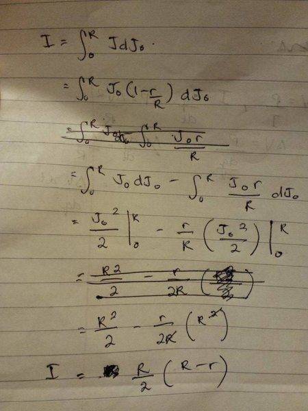

(a)The current density across a cylindrical region of radius R varies according to the equation: J=J0(1-r/R), where r is the distance from the axis of the cylinder. The current density is the maximum J0 at the axis r=0 and decreases linearly to zero at the surface r=R. Calculate the current in terms J0 and the region's cross sectional area A=pi*R^2.
(b) Now suppose that a current density was a maximum Jo at the surface and decreased linearly to zero at the axis, so that: J=J0 r/R. Calculate the current. Why is the result different for these two cases?
I=JA
I uploaded a picture of the first part but I am not sure if it's correct. I also don't know how to get the area from this problem. I am thinking of plugging the value of R from I to get the area but I am pretty sure it is not right.
You're integrating w.r.t. J_0?! That's strangely wrong!
As you wrote, I=JA but that's only when J is a constant through out A. Otherwise you have I=\int dI=\int J dA. Here J is not constant and so you should integrate w.r.t. area. But what that area is, depends on the direction of J(remember current density is a vector!). You didn't give what's the direction of J but from the area formula you given, I take it that \vec J=J \hat z. So the integral you should do is I=\int _0^R \int_0^{2\pi} J r d\varphi dr.

Thanks for correcting J_0. Can you further explain this ∫2π0Jrdφ ??

Can you further explain this part \int_0^{2\pi} J r d\varphi
Since ##J## is changing throughout the area you are considering, you have to integrate it with respect to area to get the current. ##
I=\int _0^R \int_0^{2\pi} J r d\varphi dr## is just ##
\int J dA
## in polar coordinates (hopefully you've seen them before).

I haven't but that makes sense. Thanks.
