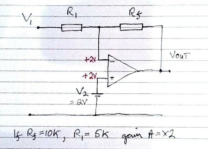

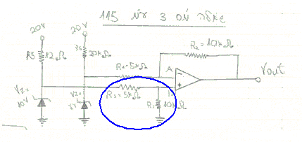

I think I'm getting better at this ((thanks to gneill, ILS, ehild and technician :wink:I'm quite sure I got it right using the easy methods (formulas). I'm not too sure about my "check up" to my solution using KCL and KVL...I didn't solve the check-up all the way because I wanted to see if my formulas are correct first.
http://img46.imageshack.us/img46/6050/helpwithit.jpg (IGNORE the mini-circuit drawn in (B)!)
I think you have V+ incorrect. The 10V from that Zener is connected across a potential divider...(5k and 10k)...I am sure you can sort that out !
Wait...I do't get it...do you see a mistake?

Can you now see what V+ is?...Then what V- MUST be...then...
The way they have drawn that potential divider is very sneaky. If it had been drawn directly across the zener diode I think you would have seen it:wink:

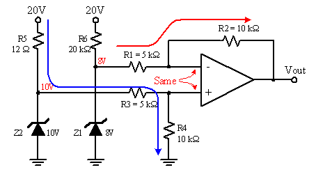

For (III), isn't the path indicated in blue the one you're describing?
Circuit schematic of an op-amp differential amplifier with two zener-regulated 10V and 8V reference branches, resistors R1 5 kΩ, R2 10 kΩ, R3 5 kΩ, R4 10 kΩ, and blue and red current paths drawn.
If so, what happened to R4?

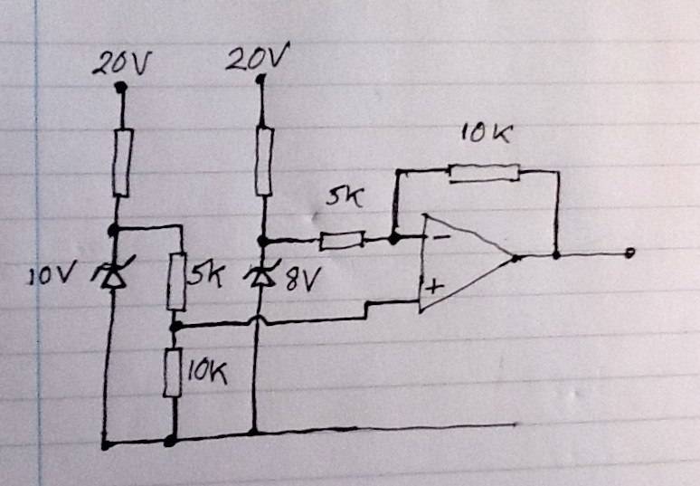

If your original circuit had been drawn like this do you feel that you would have seen the potential divider that connects to V+ more easily?
(doing this to also see if I have discovered how to include diagrams:smile:
  • Hand-drawn circuit schematic of an op-amp difference amplifier fed by two 20V supplies, with a 10V zener and 5k and 10k resistors forming a divider to the non-inverting input, an 8V zener and 5k input resistor on the inverting side, and a 10k feedback resistor.
Hello FP!
Did you see that V at the +input is not 10V?...it is a fraction of 10 because of that potential divider?
There is current flowing through the Zener diode...that is giving the 10V Across R3 and R4

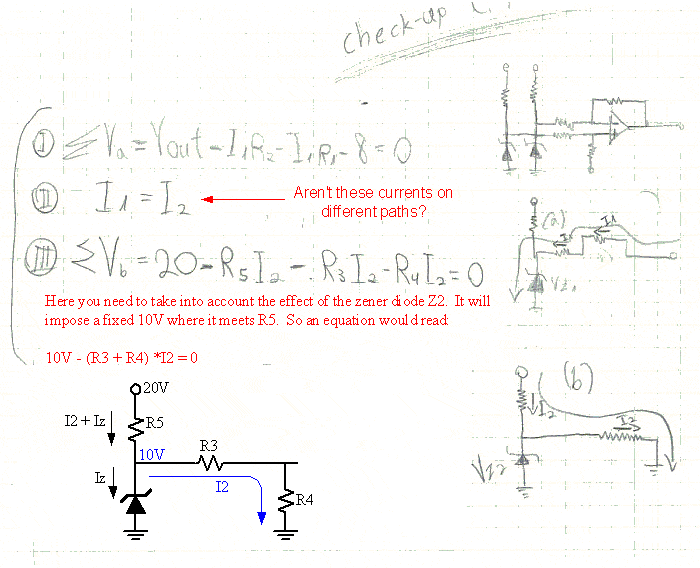

But the zener diode is not a part of the loop I chose, why should I include it?
FP:
I am a little ashamed to admit that I do not find KVL very interesting:redface: !
I know it is important but have never needed to resort to using it in op amp appications.
I am certain the usual contributers will be able to give a lot of help when they see your post... I admire and enjoy reading their responses in this area.
You expression looks OK to me because you have realized that some current goes through the
diode. You have I1 through R5 and I2 through R3 and R4.
The current through the diode is therefore I1-I2.
Cheers!

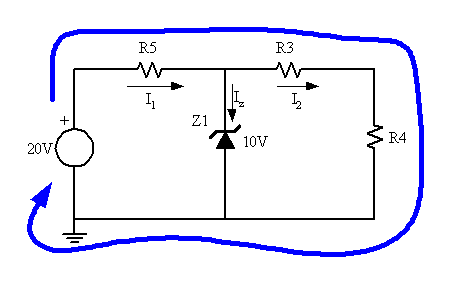

Hi FP. The zener is part of a loop which impinges on the loop you've chosen. As such, it has an influence on your loop. In particular, the current through the zener must come via R5. So R5's total current must include the zener current.
Here's the circuit redrawn to emphasize the loops and their interaction:
Circuit schematic with a 20V source, resistors R5 and R3, zener diode Z1 rated 10V, and resistor R4, with currents I1, I2 and Iz labelled and a blue loop path drawn around the outside.
The blue line represents your chosen KVL path. Note that what I've indicated as I1 must be made up of I2 AND Iz.
  • Circuit schematic with a 20V source, resistor R5 on top, a 10V zener diode Z1 with current Iz branching down, resistors R3 and R4 on the right, currents I1 and I2 labelled, and a blue loop traced around the outside.
Yes, that's exactly what I did! I split the currents in my KLV whereas
I1 = I2 + Iz
I don't see how what you say contradicts what I did.
I1 = I2 + Iz
The "-I1R5" term in your KVL equation would have to be "-R5(I1 + Iz)", since both currents contribute to the voltage drop in R5.
