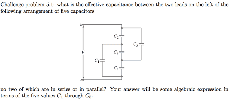

Circuit diagram of five capacitors C1 to C5 between terminals a and b, with C1 on the left branch and C2, C3, C4, C5 arranged in a bridge-like network on the right.
This problem was very difficult, and the most I could do was re-arrange the circuit into a make-shift Wheatstone bridge with all capacitors instead of resistors/voltmeter.
Any ideas?
What you need is a relevant equation ! Hence the template...
I propose Q = C V There are five of them, plus one for the equivalent over-all C, so you should get enough material to solve for the latter.
That's how we do parallel, series, etc. of two capacitors. This one is a little more involved.
I've already attempted doing that - I think the big problem is that since no two of them are in series/parallel with each other, it's very difficult to use the standard method.
Show what you did, it might be just right, only a bit confusing
I scrapped my approach because it wasn't working.
Do you mean I should calculate the charge on the capacitors using Q = VC?

Are the capacitances all different, or do all capacitors have the same capacitance?
  • Circuit schematic of five capacitors C1 to C5 between nodes a and b, with the text 'Challenge problem 5.1' above it and a voltage V across the leads.
They're all different...does that make a difference? I figure the calculation would be the same.
The special case of all being equal allows you to make a drastic simplification right from the start, basing this on symmetry of the circuit. For this reason, the special case cannot qualify as a "challenge problem". :smile:

I just write the KCL equations for complicated questions like this.
