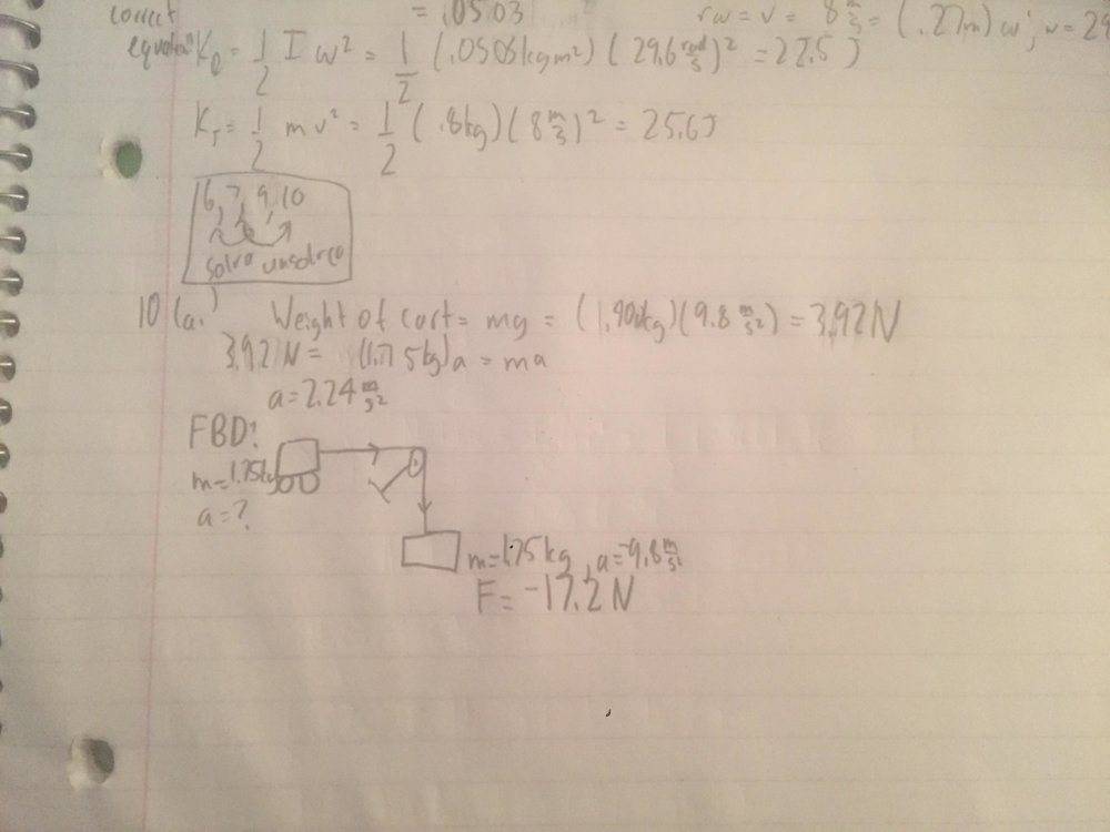

A cart with a mass of 1.75 kg is pulled by a string over a pulley attached to a hanging
mass of 400 g.
a. What is the acceleration of the cart if the pulley is considered massless?
b. The pulley has a radius of 3.5 cm and a mass of 100 g. It can be considered a
solid disc. What is the actual acceleration of the cart?
Attached
My attempt is also attached. Basically, I think I have (a) down. The only issue is I am getting the wrong answer, and I was hoping one of you could let me know if the answer key is wrong or the way I did it was wrong? The answer is 1.823m/s^2. Also, for the second part, I am really not sure where to go from here. If someone could get any advice that'd be awesome. (Also, the answer to (b) is 1.782m/S^2.

i_love_space_and_eng said:
Problem Statement: A cart with a mass of 1.75 kg is pulled by a string over a pulley attached to a hanging
mass of 400 g.
Relevant Equations: Attached
Please see post #2 at your prior posting of this problem, https://www.physicsforums.com/threa...-moment-of-inertia-problem-difficulty.972618/.
Also, please do not post algebraic working as an image. That is for diagrams and textbook extracts. Take the trouble to type in your work. That is generally much easier to read and allows those responding to quote specific lines for reference.

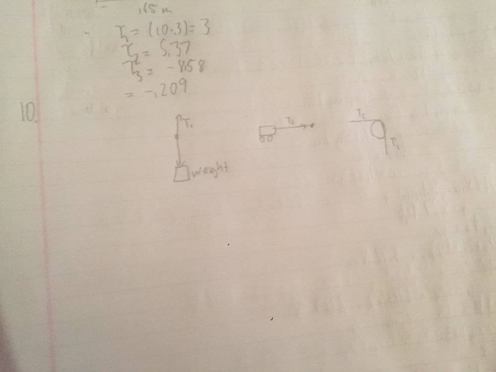

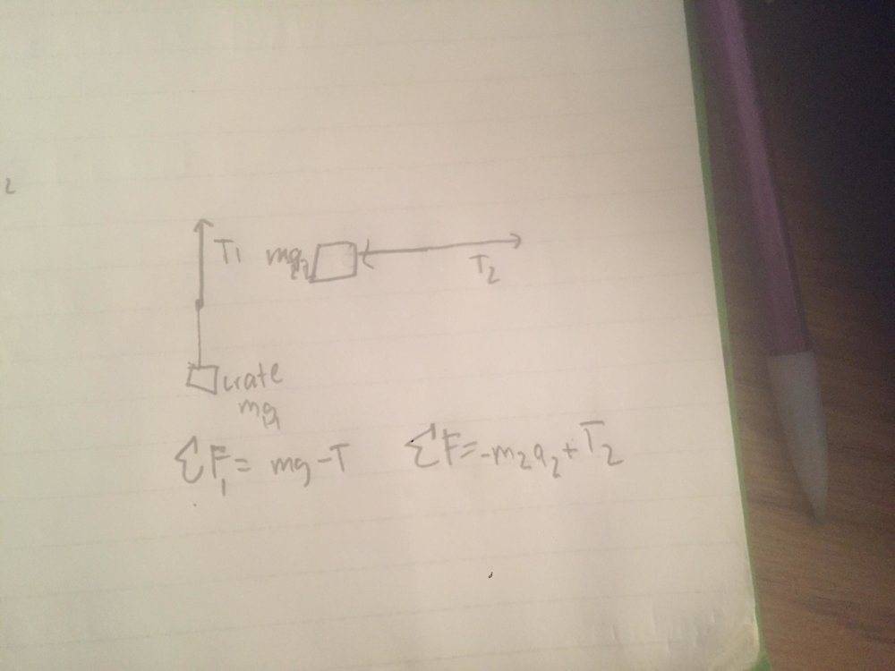

As I posted, draw separate FBDs for the hanging block and the cart. Assign an unknown T as the tension. Write out the ΣF=ma equation for each
Alright,
Here i have my fbd1 and fbd2 attached. Any advice on where to continue from here?
Alright,
##m_2a_2## is not a force acting on the cart. How are the magnitudes of the accelerations of the cart and the crate related?
Are they related by the force of the string connecting them?
How are they related kinematically, given that the length of the string is constant?
I would say the gravity pulls on the mass, and the mass pulls on the string, which pulls on the cart?

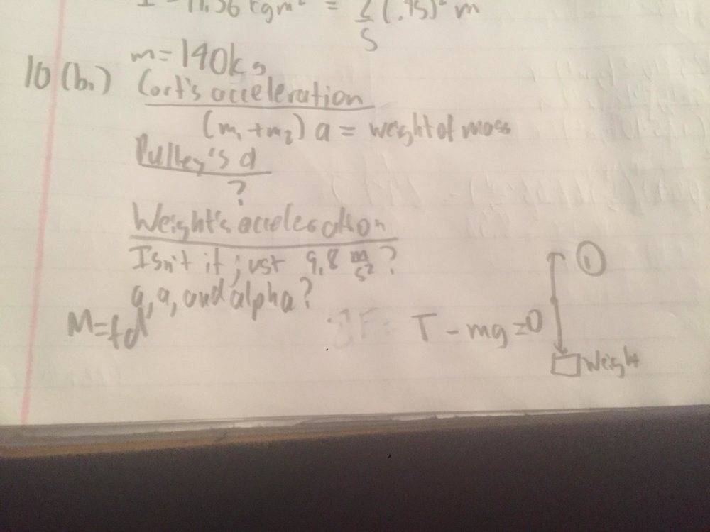

I actually think I found a and it makes sense... Now here is my work for (b).
Σt=Ia
T-mg=(6.125*10^-5kgm^2)a
T-3.92N= (6.125*10^-5kgm^2)a
Not sure how to find T though... Did I even set that up correctly? Any advice on where to go from here?

As I wrote in the other thread, for part b you need three FBDs; one for the cart, one for the hanging mass and one for the pulley.
The tensions in the two sections of string are now different.
Again, the accelerations are related, but for the pulley it is an angular acceleration. To avoid confusion, please use a different label for that; α is customary.

Great. Okay, so here I have drawn out the fbds for all three.
Is this correct?
Is this correct?
Good. Now let's see the force and moment balances that go along with the relevant diagrams.

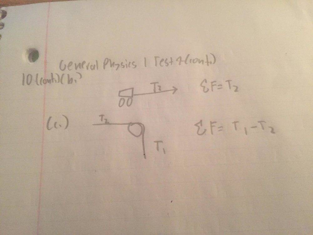

Alright, I think I have that done. Please see below.
You realize that you've been asked to type this stuff in, right? "Writing" means "typing". Taking pictures of handwritten text does not count.

I want to see 3 separate equations: a force balance on the cart, a force balance on the crate, and a moment balance on the pulley. These equations should have net forces or moments set equal to ma or ##I\alpha## (I don't want to see any ##\Sigma F's##).
I took pictures so it could be easily seen next to the figures. I've typing out otherwise when I was first told.
Alright, here is my best attempt. I am trying to do what you have stated, but I am not sure how without equaling it to something. But here it is:
Force balance on cart: T2 only, because no other force is acting on the cart.
For balance on weight: T1-mg
Moment balance on pulley: I'm a little confused by this. Would it be T1+T2?
For each tension, consider whether the torque it exerts on the pulley is clockwise or anticlockwise.

I don’t see any ma’s or I alpha’s. A force balance is an equation. An equation has an = signs.
Okay...
For T1, it would be clockwise. and for T2, the same.
