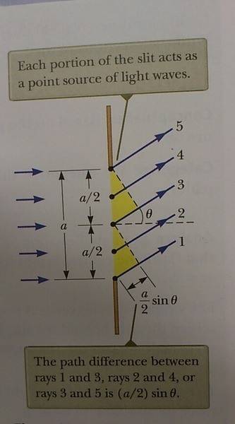

Is it necessary that a single slit diffraction occur with the two source having the distance of \frac{a}{2}?Are there any diffractions occur when the point source having the distance of \frac{a}{3},\frac{a}{4} and so on?
And I would like to know whether are there only destructive interference occur?

Hi Ha,
There are no two sources in the drawing; there is only the one slit opening that is imagined to be subdivided into two "sources" that are deemed a/2 apart. As you correctly suspect, it is equally well possible to subdivide into 3, 4, 5, etc. sources (with successively smaller extension / width) that interfere constructively at greater and greater angles. In the resulting intensity pattern the angles in between have destructive interference.
The intensity at a given point on the screen is in fact an integral over the slit opening. See e.g. Fraunhofer diffraction or Single slit diffraction.
The resulting intensity pattern is ##{\sin^2 x \over x^2}\ ##; ##\ \ \ {\sin x \over x}## has been found to be important enough to get its own name: ##{\rm sinc}\ x##
