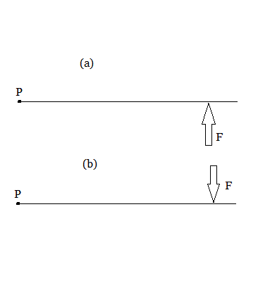

Hi. I'm really confused in how to find the moment done by force.
I want to find the moment done by the force in this figure.
The book has resolved the force into its components using principle of moments.
So, how do i find the moments of the components of the force? I know I'm going to use the right hand rule, but i don't know where i am going to put my thumb.

You don't need to calculate that.Moment is a turning effect.It does not have any directions.It has direction of rotation.You just have to use common sense and decide whether it's anticlockwise or clockwise
For example,look at this:
Look at diagram a,Force F produces an Anticlockwise moment.
Look at diagram b,Force F now produces a Clockwise moment.
Think about your diagram now
Okay. But there is something called right hand rule that you indirectly used to find the direction of (a) and (b).
I want to know how the right hand rule is used.
I know what your saying. Your taking a direction vector from point O to the line of action of the force. And by using cross product, you're getting the magnitude and direction. But I'm not using that method. I'm using Varignon's theorem.
