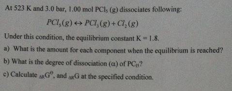

Hi, I tried the following task:

Can you justify your 3× factor ?
In the task it says, that the pressure is 3 bar, so i used this value for the partial pressure
is this wrong?
OK got that - I was reading rapidly and imagined it was some mixup deriving from the 3 in PCl3.

When I try it that way, I get 0.019M for PCl5 at the end and 0.05M for each of the resulting substances. Therefore the dissociation degree of PCl5 would be 73% since the start amount was 0.069M. Do these values make sence?
I will understand the question to be that the pressure was 3 bar at the end of the reaction. I guess it doesn't matter what it was at the beginning. That is the simplest thing but I don't know how you get your start molarity. The way I do it at STP I remember one mole gas occupies 22.4 L, therefore 1 L at STP contains 1/22.4 moles ≈ 0.0446 M. so if it is 3 bar that is about 0.14 M. (though that is not very far from your final total molarity). So maybe you are in the right ball park but unless you set it out a bit more it is not very clear.
Oh i thought that the 3 bar were at the beginning, so I converted everything in SI units and used p*V=n*R*T to get the volume. Then i converted the volume in liters, and divided the starting amount of moles to get the mol/l which I used to calculate the values

The quoted K is based on partial pressures expressed in bars. The equilibrium constant is dimensionless because the standard state of each species is 1 bar.
If x is the number of moles that dissociate, the total number of moles increase to 1+x, so the final mole fractions are x/(1+x), x/(1+x), and (1-x)/(1+x). If the pressure is held constant at 3 bars, then the final partial pressures are 3x/(1+x), 3x/(1+x), and 3(1-x)/(1+x). Try the problem again with these substitutions and see what you get.
