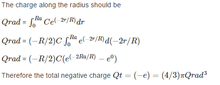

Suppose the hydrogen atom consists of a positive point charge (+e), located in the center of the atom, which is surrounded by a negative charge (-e), distributed in the space around it.
The space distribution of the negative charge changes according to the law p=Ce^(−2r/R), where C is a constant, r is the distance from the center of the atom, and R is Bohr's radius.
Find the value of the constant C by using the electrical neutrality of the atom.
I don't think I understand the charge distribution very well. I tried integrating the total negative charge of the sphere ( atom ), since I know it's equal to ( -e ).
Please show us what you did when you integrated the distribution.

Typeset derivation of the radial charge integral Qrad = integral from 0 to Ra of C e^(-2r/R) dr, substitution to (-R/2)C times integral of e^(-2r/R) d(-2r/R), evaluation to (-R/2)C(e^(-2Ra/R) - e^0), and total charge Qt = (-e) = (4/3)pi Qrad^3.
Sorry about the format. I don't know if the last line makes sense.
In the way I understand it the negative charge in a point should be p = Ce^(-2r/R). However I think i am wrong. Thank you in advance.
You cannot do it like an integral in one dimension, the distribution is three dimensional.

Yes, it's three dimensional, for a three dimensional point. But can't I integrate it for the whole radius, and then use the standard volume formula?

The modulus square of a wavefunction, ##p(r)## in your notation, describes the probability density of the electron and it has a dimension of inverse volume. You can therefore build the charge density ##\rho(r)## by multiplying ##p(r)## with the electron charge ##e##, so ##\rho(r) = e p(r)##. The total charge is then just the integral of this quantity over all space, not just until certain radius like you did there.
