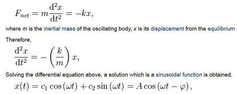

A ball bearing is placed on a track curved in the vertical plane. The ball bearing is released from a position on the track above the lowest point and it then oscillates with SHM. As the amplitude diminishes does the time period for each oscillation stay the same?

I know that for SHM the acceleration produced by the restoring force is proportional to the negative of the displacement. I am familiar with the derivation of the simple pendulum using the horizontal and vertical components of the force arrive at the formula for T.

You are not told the shape of the curve. You are told the only thing that matters: the motion is SHM. That allows you to write a generic equation (no need to derive it from consideration of forces), and that equation implies the period is independent of the amplitude.

So by definition a body oscilating under SHM will have a constant time period
The differential equations are a little beyond me, so can I tell from the solution that the time period is always independent of the amplitude?

Yes. From the A cos (ωt-θ) solution, the values must repeat as t increases by multiples of 2π/ω.
Or, looking at the DE, if x=x(t) is a solution then so is Ax(t). Therefore the amplitude can change without affecting the function in any other way.
