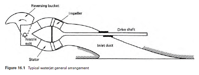

Here's a picture of an impeller from J S Carlton (Marine Propellers and Propulsion 2nd edition 2007)
If I understand correctly, the driveshaft is there for the gas motor. If I had an electric motor, could I just use coils around the impeller? Or, alternately, can I drive an electric with gas?
Thanks
Joe

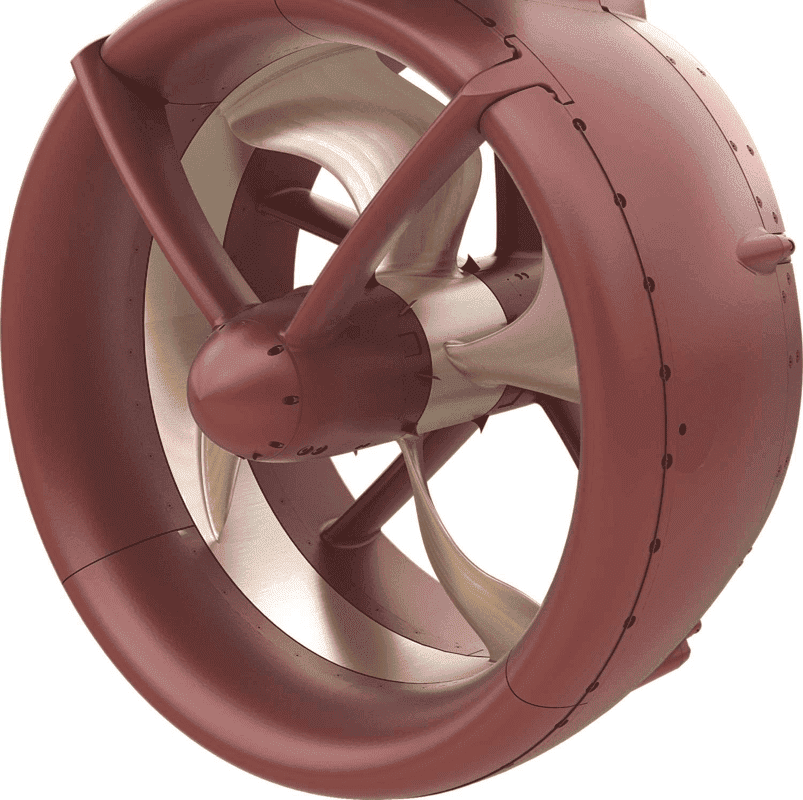

OK, very cool. This is now a project worth pursuing.
Yes, there are several marine propulsion designs that do basically that. You may need a much bigger diameter of that duct. Here's one that uses permanent magnets. I'm not sure what their top RPM is. I just searched "marine magnetic propulsion".
Likes berkeman and theycallmevirgo
Yeah I looked at the first link, if their efficiency is as they claim it is very promising. Thanks for the help folks!
