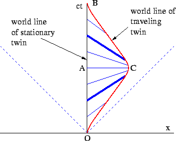

Sorry, this is the only image I could find on Wiki Commons. I realize that it shows the "corner" as rounded off signifying a more realistic acceleration for the turnaround. This would be the spacetime diagram drawn in the Earth twin reference frame, correct? With his worldline from O to B in a straight line, and the traveling twin's worldline going from O to C and C to B? (Sorry to change the conventions we have been using)
Minkowski spacetime diagram with axes ct (vertical) and x (horizontal) meeting at origin O; stationary twin's straight worldline runs from O up to B, traveling twin's red curved worldline goes from O to turnaround point C and back up to B, with blue simultaneity lines and point A on the ct axis.
So I was envisioning that if the spacetime diagram drawn in the reference frame of the traveling twin who considers himself at rest the entire time, that is image would be symmetric along the ct axis. Obviously not right.
  • Minkowski spacetime diagram with axes ct (vertical) and x (horizontal) meeting at origin O; stationary twin's straight worldline runs from O up to B, traveling twin's red curved worldline goes from O to turnaround point C and back up to B, with blue simultaneity lines and point A on the ct axis.
There's a difference between a rest frame and an IRF. In a previous thread I analyzed this problem from the traveller's outbound IRF. In this frame, the Earth moves with constant velocity. On the outward leg, the traveller is at rest in this frame. But, on the homeward leg the traveller is also moving in this frame.
The thing the traveller cannot do is associate their rest frame with a single IRF throughout.
Yes.
I think you mean, that it would look like a reflection of the Earth twin diagram about the ct axis. The answer to that is probably not, but that answer by itself does not address the key problem.
The key problem is that, as has already been said, any "frame" in which the traveling twin is at rest the whole time is not an inertial frame. That means that, no matter what the spacetime diagram in that frame turns out to look like, you can't draw any conclusions based on it the way you can draw conclusions based on a spacetime diagram drawn in an inertial frame. For example, in a spacetime diagram drawn in a frame in which the traveling twin is at rest the whole time, the traveling twin's worldline will look like a straight line. But you cannot conclude from that that the traveling twin does not feel acceleration, or that his proper time between the start and end events is maximal; whereas you can conclude those things about the Earth twin from the diagram you showed, drawn in the Earth twin's rest frame, because that frame is an inertial frame and you can draw conclusions like that from a spacetime diagram drawn in that frame.

laymanB said:
Time to get a better handle on frames.
You might also consider becoming more familiar with the geometric viewpoint. For example, earlier I said it should be obvious that the traveling twin's frame is non-inertial. The geometric viewpoint makes it easy to see why.
Consider that in the worldlines of the Earth twin and the traveling twin we have two different curves between the same two points in spacetime (A and B). There can only be one curve between any two points in spacetime that is a straight line (for the same reason there can only be one curve between any two points in ordinary Euclidean space that is a straight line). We are told in the problem specification that the Earth twin's worldline is a straight line; therefore the traveling twin's worldline cannot be one. And if the traveling twin's worldline is not a straight line, the frame in which he is at rest--which means his worldline has constant spatial coordinates--cannot be an inertial frame, since only a straight line can have constant spatial coordinates in an inertial frame.

In fact, here is the scenario analyzed from the traveller's inbound frame.
Two common misconceptions are the role of acceleration and that it's the traveller's time, and not the Earth's, that is really dilated. This analysis should dispel those ideas.
We have a ship traveling towards Earth at ##\frac35 c##. We will analyze the problem from this frame. So:
The Earth moves towards the ship at ##\frac35 c## throughout. The Earths gamma factor is ##\frac54##.
The traveller leaves the Earth at ##\frac35c## in the Earths frame and moves towards the ship at ##\frac{15}{17}c## in the ship frame(*). It's gamma factor is ##\frac{17}{8}## in the ship frame.
(* You use the velocity addition formula here to get the traveller's velocity in the ship frame.)
Let's assume that the Earth is initially a distance of ##7.5## light years from the ship.
According to the ship:
The traveller takes ##8.5## years to reach the ship. At which point the travellers clock reads ##4## years.
The Earth takes ##12.5## years - a further ##4## years - to reach the ship, at which point the Earth clock reads ##10## years.
Now, we adopt the scenario where the traveller, instead of turning round, asks the ship to record the time of the return leg. After all, the "incoming" ship is traveling at the correct speed relative to Earth and represents exactly the idealised change of motion required for the experiment.
When they pass the traveller's clock read ##4## years. This reading was transferred to a spare clock on the ship, which recorded a further ##4## years before the Earth arrived.
This confirms that if the traveller could instantaneously change direction, the results would be the same as obtained from the Earths frame.
In one sense, these calculations are pointless. If you have confidence in the physics, then you analyse the problem from the Earth frame and that's that.
But, perhaps it's good to see the same result from a frame where the Earth is moving and time dilated throughout. And, where there is no need for acceleration.
