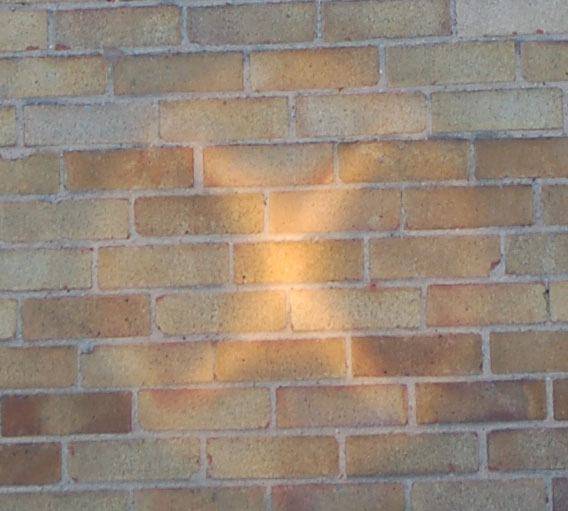

I hope this is not a stupid question but I attach a photo of a reflection of a square double glazed window showing on a wall opposite the window. Could someone please explain to me what is happening here. I presume the outer circular reflection is showing the extent of the suns rays and the cross is a separate reflection of both panes of glass. Is that so and if so why does it show as a cross?

Pretty cool question. Can you clarify -- this is a reflection off the window that is hitting an exterior wall outside the window? Can you post a sketch of the position of the sun, window and exterior wall?
Or is this an image of the Sun formed on an interior wall after the Sun's rays pass through the window? If so, a sketch would still help. Thanks.

Hello Everone. Thanks for your replies. Sorry about the delay in responding only I didn't get a notification of any replies by email as I elected to do. I list my answers to some of your questions.
1) Berkeman, the reflection is on the wall opposite the window. The sun was approximately 20 degrees to the right of the reflection past the wall and was low down in the sky towards sunset. When I opened the window, the reflection obviously moved to a new position.
2) Sophie, not sure how I can describe the situation any clearer. As I said above, the reflection was on the wall. I could see it there when I went outside. I don't understand. Why is that a puzzle? Glass reflects like mirrors do. I did wonder if the glass was distorted and slightly curved.
3) Blue, I didn't think to try pressing the glass to see any shape change in the reflection. I'll try that if I see the reflection again.
4) Russ I suppose that it is technically a refraction in that the light is passed from one medium to another but I think of it as a reflection.
I hope that answers the questions satisfactorily. Thanks again for the responses. Best wishes. Brian

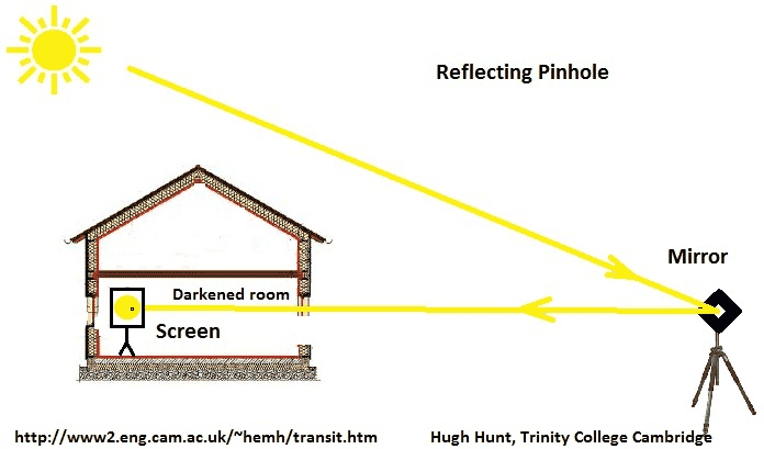

In the case of a flat mirror (or flat window) reflecting the sun, the effect is the same as pinhole camera or a pinhole in a shoebox used to observe solar eclipse. This is something I've learned from experiments when I was 10 years old (ages ago last millennium).
You have not remembered your elementary optics quite correctly. There is no equivalence between the pinhole and a large flat reflector images. If you had taken your shoebox and made two pinholes in it, the image would have been two Suns. n pinholes produce n Suns, side by side and a large square hole An infinite number of pinholes produces an image that's square and of a similar shape as the hole and larger, according to the ratios of hole size, projection throw etc. ). Without some curvature, you can get no real image formed. Why would anyone use a lens if a big hole would do the same job?
As I said before, the mirror acts in the same way as a hole of the same size. If you stand, looking through the window at he Sun , you will see the sun as you move around the room until its gets to the edge of the window. A small Penumbra region and then you don't see it. Ditto for the reflection from a large window. It's elementary shadow geometry.

That's a good image, repeating the effect in the OP. I can't think there's any doubt that it's a focusing effect of a curved reflector. Although they still don't mention the actual distance between window and wall we now know we're talking in terms of across a street (say 50m). That must be similar to the curvature of one of the glass faces (it could be either) to form that basic part -focused spot. Pressure differences due to heating of the units on a hot day could make the bowing worse. The actual shape of the glass wouldn't be spherical, the curvature would be different along the diagonals and for the verticals and horizontals. That's astigmatism, which produces that sort of distortion.

Number the surfaces, 1 is external outside glass, 2 is coated with metal film, 3 and 4 are the inside pane. The inner surface =2, of the outside pane is coated with a metal film which makes it partially reflective. The metal particles are probably of a size that selectively reflect long wavelength IR, while allowing shorter wavelength visible light to pass.
The double glazed window is filled with a low pressure dry gas to protect the metal film and prevent internal condensation. That pulls the two glass sheets slightly closer together near the middle, which curves the panes.
The outer pane with surface 1 and the more reflective metalised surface 2, is slightly concave, so it tends to focus the sun into the centre of the reflection on the wall.
Because the window frame is rectangular, there is a boundary condition that causes the pane to be flatter at the straight frame sides. Therefore a slight trough forms from the four corners to the centre. Those diagonal corner troughs reflect the light that forms the 'X' on the wall.
Meanwhile the inner pane is convex which makes it divergent. External light, reflected back from surfaces 3 and 4 will be attenuated twice by having to pass through the coated layer 2 twice. That divergent rear reflector will tend to light the whole area of the wall. The flatter areas of surfaces 3 and 4, constrained by the straight frame, may be generating the faint outer circle.

Similar cross and circle reflections occurred at a university building in Germany. Physicists investigated the phenomenon and published their results in the Eur J Phys (2014), with a lot of interesting images. [pdf]
From their article:
  • The increased use of double pane windows in recent decades has led to an increase of observations of everyday life sightings of reflection images of strange and varying geometrical forms.
  • The best conditions to observe the phenomena are a low shining sun and a street running perpendicularly to the direction of the sunlight, i.e. near normal incidence of light onto the window.
  • For a given location, the phenomenon can be observed for a couple of hours each day for a period of several weeks within a given time of the year.
  • If the projection wall distance changes, it may well be that the same window results in crosses for nearby projection and round spots for more distant projection.
  • The concave, focusing pane gives rise to an extended cross-like structure whereas the convex defocusing pane yields the outer rhombic-like feature.
  • Applying a force to the inside of a double pane window (manually pushing against the center of one pane) changes its inside pressure (not a vacuum) and therefore the geometry of the outside pane. The originally in focus image changes into an out of focus projection on the wall while applying the force.

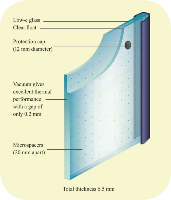

I have to wonder how much 'vacuum glazing' you can find amongst your average windows. The internal supports would be very visible and I can't say I've ever noticed their presence in the units I've seen. (Excellent for some applications, no doubt.)
Vacuum Insulated Glass is not yet widely used. The spacers, on a 20 mm grid can be made from stainless steel or glass, with a thickness of 0.2 mm and diameter 0.6 mm.
I think you could ignore them in most applications as they are out of focus and smaller than the pupil of your eye.
