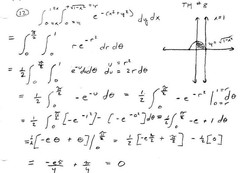

Double integrate from cartesian to polar and then evaluated
1 reply · 2K views
jimbo71
80
convert double integral from line one to polar integral and then evaluate
see problem 12 attachment
y=rsinx
x=rcosx
r^2=x^2+y^2
I calculate a area of zero. are my limits wrong and if so which ones, or did i make a mistake in the aritmatic, or something else?

You start to go wrong at the end of the 5th line. [itex]e^{-1}[/itex] does not equal [itex]e[/itex].
