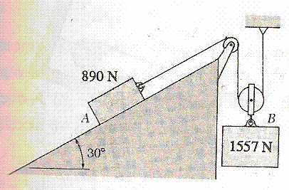

The two blocks shown in the figure are initially at rest. Despise the masses of the pulleys and the friction between different parts of the system. Get (a) the acceleration of each block and (b) the tension in cable.
Answer:
(a) aA = 2,56 m/s^2; aB = 1,28 m/s^2
(b) 677 N
Answer:
(b) 677 N

Hints: Identify the forces acting on each mass. (Draw a free body diagram for each.) Apply Newton's laws to each mass.

My solution (not find the answer)
Block A
ZFx = m.a
T1 - Psin(30) = mA . aA
Block B
zFy = m.a
-P + T1 + T2 = mB . aB
And:
T2 = 2T1
2aB = aA
Solving the system. I find:
aA = 1,14 m/s^2
aB = 0,57 m/s^2
T2 = 1097,92 N
Apprentice123 said:
Block A
ZFx = m.a
OK, I presume P is the weight of block A. Better to use mAg instead of P.
Block B
zFy = m.a
Don't use the same symbol, P, to represent the weight of block B. Also, since the pulleys are massless and frictionless, the rope has a single tension throughout. Just call it T. So what's the total upward force on block B?
And:
T2 = 2T1
See comments above.
2aB = aA
Be careful with signs. If block A moves up the incline, block B must move down.

Block A
ZFx = mA . aA
T - mA . g . sin(30) = mA . aA
Block B
ZFy = mB . aB
-mB.g + 2T = mB . aB
aA = - 2aB
New is correct thank you very much
I find:
Block A
T - Psin(30) = 90,72aA
Block B
-2T + P = 158,7aB
How can I relate aA and aB ?
See your last post:
Apprentice123 said:
aA = - 2aB
Doc Al said:
See your last post:
Thanks.
if I had two pulleys in B the accelerations were aA = -4aB ?
It would depend on how they are arranged.
