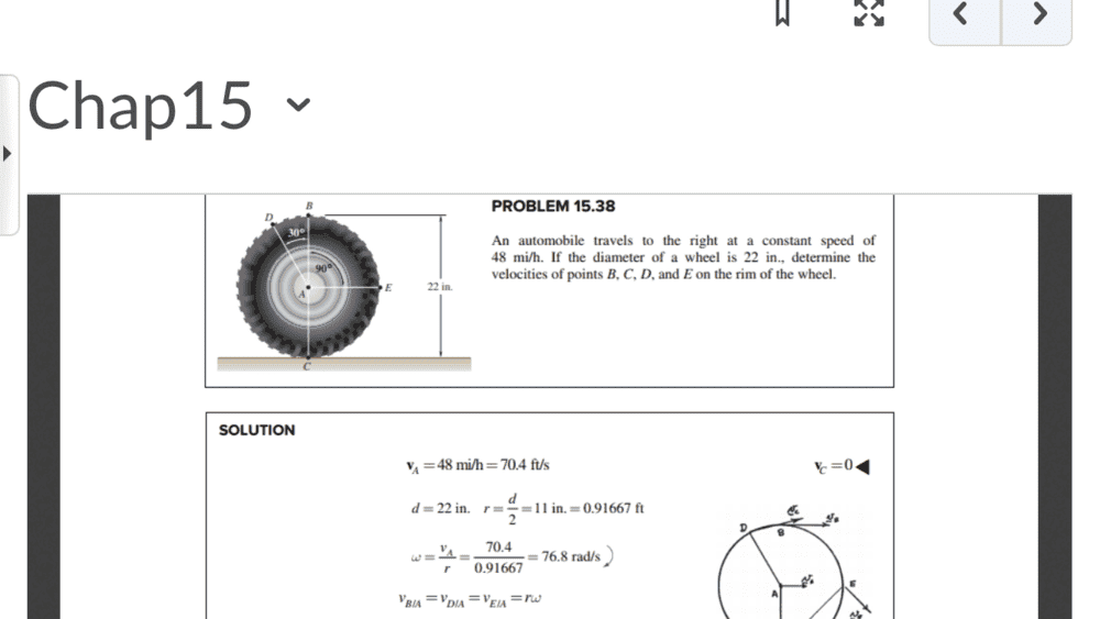

An automobile travels to the right at a constant speed of 48 mi/hr. If the diameter of a wheel is 22 in., determine the velocities of points B,C,D, and E on the rim of the wheel.

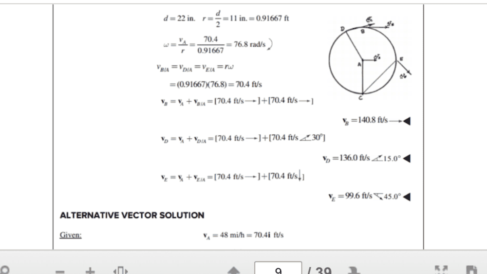

V_b = V_a + (w)X(R_ab)
The solutions used the spend of the wheel and its radius to find the angular velocity. I’m confused because I thought to find angular velocity you use the speed at the points of the radius not the translation speed of the wheel itself. Can someone explain this to me please

Think about what happens if the wheel is moving faster or slower than the translational velocity where the wheel touches the road. If it is moving slower, it is being dragged. If it is moving faster, it is slipping (or spinning). Therefore under smooth rotation, it is moving at the translational velocity.

Since B,C,D,E are at the same radius they have the same angular speed wr (with respect to point A) which has the magnitude of the translational velocity. Velocity also has direction associated with it so they are moving in different direction with respect to point A. Point A also has a directional velocity which has to be added to these velocities.

Imagine that you are moving with the translational velocity of the car. In this frame, point A does not move and it looks like the wheel is just rotating in a circle without any translation.
I am going to try and start again. For a point on the edge of the wheel, there are 2 velocities, the translational velocity of the car (and point A) and rotational velocity about point A. This problem is essentially asking you to add these two directional quantities. Do you understand this?

Let’s say the car travels a distance equal to the circumference of the wheel. Do you believe that the wheel has undergone 1 rotation?
Yes
Ok. Since the car travels 1 circumference we know
vt=2PiR
Since the wheel rotates once during the same time we also know
w=2Pi/t
Substituting to cancel t gives w=v/r
Does this answer your question?

That’s not how I would put it. The wheel is rotating at a constant rate, so w is still determined by the velocity of the points that are some radius away from the centre. In this case, the wheel is also translating, so one has to figure out how this modifies the velocities of the points on the wheel.
The velocity of a point on the wheel is v_rotational plus v_translational. The non-slipping wheel condition gives a relationship between v_rotational and v_translational.
Non slipping mean no acceleration right?
Non-slipping is when the number of wheel circumferences traveled by the car is equal to the number of wheel rotations. There can be acceleration. Slip conditions are everything else (for example: the extreme cases I proposed in post #2).
Ok so V_wheel=wr is when the wheel is rolling without slipping
Also how would Ik that this problem is rolling without slipping since it’s not directly stated and there’s no mention of the arc length traveled being equal to the displacement of the wheel
The no-slip condition describes how we think a wheel normally works. The problem assumes that you know this. I could see a homework problem where you were expected to develop the condition yourself, but from the solition this wasn’t it.
