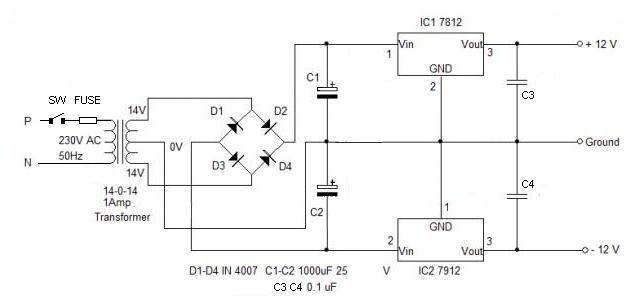

Ya I have been asking around and yes for this low power circuit a fuse in the primary is what I need, thanks! :)
But one more thing, I am running small thing like a fan and LEDS and the way my pcb design is right now it will be a little tough getting the regulated + and - to the output terminals for the fan and LEDs, but it is perfiect for useing the center tab and a line from the transformer then send it through a half wave rectifier and filter to the LEDS and Fan. So even though I am using the center tab in most of my circuit can I still use it for power?(understanding it will be half the voltage) , this may be a stupid question but I don't want to mess this up.
Hey TD good to see you are still having fun and experimenting
I did a dual supply circuit for some one else in another thread
if you have something similar maybe a different voltage ... there's no problem just using 1/2 the supply, say, the0V rail and the +12V ( or whatever your one is) rail

the power supply filter capacitors ... say the C1 and C2 in my diagram
their value if governed mainly by the corrent the PSU is expected to supply the rule of thumb
value is 1000uF per Amp. There's no harm using larger caps, but if you use ove less than the
value you should be using, it means there will be more ripple present, which may be heard as hum
or distortion on the audio output
Dave
Ok i think ill take it safe and do 6800uf then. Will the fuse before the primary protect from a crossed circuit on the secondary?
it will remembering that the primary current flowing and thus the fuse size will be much smaller than the current flowing on the secondary side.
Some one here much better at maths etc could tell you that if you have say 2A on the secondary, how much current is flowing through the primary ... I should be able to answer that ... but not too with it at the moment :wink:
For any supply that has significant current draw on the secondary, anything more than an Amp or so, I personally would also fuse the DC line(s) out of the rectifier. Experience has shown me that it will react (blow fuse) a lot faser than the fuse on the primary
A fuse in the primary really excells for primary side power faults, power spikes, shorted turns in the transformer etc
Dave

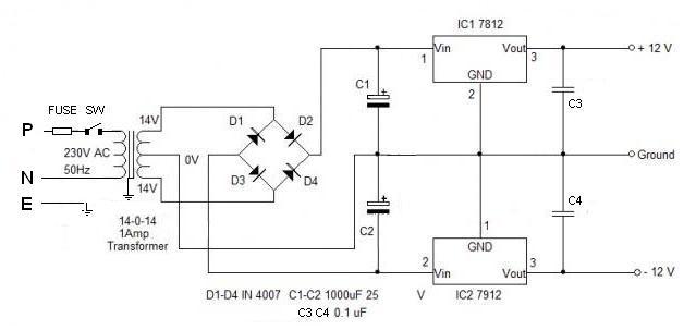

Hi TD
just had to do a couple of little but important changes to the diagram
the new one is below, won't affect operation, but will affect the SAFETY :smile:
all around the power input area
1) swap the fuse and switch positions
2) show incoming Earth line
3) show the Earth connection to the transformer core
cheers
Dave

@Tesladude -- you haven't answered my question about why it's important to connect Earth ground from the input power cable to your metal enclosure for your power supply. If you are making this power supply for a fee, it's real imporatnat that you get it approved by a safety agency (UL in the United States). Or at least design and build it to the applicable safety standards. You open yourself up to some pretty serious lawsuit issues if your device hurts somebody via shock or catches on fire because it doesn't conform to industry standards.
So please tell us, why did Dave swap the position of the fuse and the switch in the schematic...?

I am making this for an acquaintance of mine, not producing and selling, but I understand I must still make correct safety procedures.
I do not know why the fuse and switch are switched nor why the transformer should be grounded, I have an idea but honestly do not know, but allas that is the reason I am here, to learn.
So please enlighten me on the reasonings behind these safety precautions.

It's not so much that the transformer should be grounded (most transformers do not offer a place to make an electrical connection to the core material). It's that you should use a 3-prong power plug (at least in the US -- Europe is different I believe), and make a solid mechanical connection from the Earth Ground lead in the power cable to the metal enclosure of your power supply.
The reason is to help protect against single faults of the Hot wiring in your power supply. You absolutely want to guarantee that if there is a single fault, that it cannot cause the metal enclosure to become energized with the Hot voltage. That would present a serious shock hazard to any user of the power supply.
So if there is a single fault in the HOT wiring inside the power supply, and a loose Hot lead makes contact with the metal enclosure, that will blow the Hot entry fuse and open the circuit. That's why the very first place the Hot lead needs to go when entering the power supply is to the fuse, and not to something like a switch before the fuse.
Be sure to wire the fuse so that the Hot end is the end away from the user-accessible end of the fuse enclosure (if you are using a panel-mounted tubular type fuse). Also be sure to use a good wire grommet arrangement to mechanically strain relieve the power cord as it enters your power supply enclosure. The cooling holes that you drill in the top and bottom of your enclosure need to be too small to be able to drop a paperclip into, especially over the AC Mains wiring portion of the power supply. All AC Mains wiring should be totally inaccessible by human hands/fingers when your power supply enclosure is closed up.
There are other safety considerations about shock hazards and fire hazards, but those are the main ones for power supplies powered by the AC Mains (again, in the US where Underwiters Laboratories or UL is the main company where you submit your designs for testing and approval).
If others have some additional safety rules to mention, please chime in. Also, if anybody can speak to variations in this for European safety approvals, that would be helpful.
Another point -- it is good practice to put heat shrink tubing over the connections from the Hot & Neutral wires to things like the fuse contacts, switch contacts, and connections to the primary side of the transformer. These make no difference when the product is closed up obviously, but make a big difference in technician safety when the product is opened up for service.
