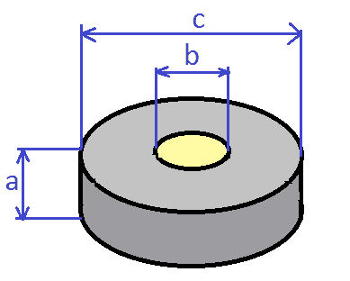

Aluminum foil reels have to be preheated for manufacturing but it's inefficient (the doors aren't sealed and the material isn't in close contact with heating elements at the sides). I'm considering an initiative of more efficient design.
How difficult would it be to evaluate heat transfer if each real is also in a plastic bag (so I have to consider different mediums)? Since it's aluminum foil I guess I should go with conduction and try to design heating elements tightly around each reel. The goal is to heat the the material fast to 50C thoroughly but never going over 60C.

At the moment I can only provide approximate specs but here's the deal:
The foil is about 18cm in width, 30cm in diameter and inner core of about 10cm in diameter;
It is in a plastic bag that cannot be opened during heating because the menthol would evaporate;
It's the kind of foil that's tin one side and paper on the other;
After heating it has to be in the range of 35C to 60C throughout.
If I had all the conduction indexes maybe I could at least evaluate it theoretically. I'd have to somehow calculate heat flow to the bag, through the air in the bag, to the foil through all double sided layers of it considering the dimensions and everything. You think it's too complex?
Could you at least take me through calculations to evaluate heat flow in the reel? The model seems to be quite complicated:
a - width, b- inner core diameter, c - outer diameter;
th - thickness of one layer, l - length of unwrapped foil.
∆Q/∆t = -K×A×∆T/th -- (wikipedia)
∆Q/∆t is the rate of heat flow; -K - thermal conductivity factor; A - surface area; ∆T - change in temperature; th - thickness of the material
How do I transform this equation for multi-layered material transfer flow, i.e. foil wrapped around itself?
The goal is to find out how long would it take for the entire reel to reach above 35C degrees heating it in 60C degrees camera.
