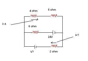

Ok here's my question:
For the cirucit shown in the drawing(attached), find the current (I) through the 2.00 ohm resistor and the voltage (V) of the battery to the left of this resistor.
Ok, should I be using Kirchoff's drop=rise, and junction rules?
It doesn't seem to work because my voltage is also unknown. Could I possibly add them resistors in series/parallel?
Any directions appreciated. Thanks :confused:

Ok for those who can't get it:
4ohm 8ohm
| ---->3amps |
|__/\/\/\_______|l____|
| 6ohm 24V |
| <--- I=? |
|___|l________/\/\/\__|
V=? 2ohm
That's the best I can do with keyboard lol.
Darn, picture got messed up. sorry. The I=? is suppose to be far right, so with the 24 V.

Which branch (top or middle) does the "3 amps" refer to??
(Hint: Enclose such diagrams within CODE & /CODE tags to preserve spacing.)
It refers to the top one, and the one you have to find refers to the bottom one, sorry. I'm not too familiar with tags but I'll keep that in mind thanks.

The solution is obtained using Kirchoff's Laws. For this purpose, the following are established:
{(+) Current Direction in Top Branch} = {Left-to-Right} = IT
{(+) Current Direction in Middle Branch} = {Right-to-Left} = IM
{(+) Current Direction in Bottom Branch} = {Right-to-Left} = IB
We first note the Top Branch has equiv resistance RT=(4 + 8)=(12 Ω) thru which flows (3 amps), thereby indicating a voltage drop (using Ohm's Law) of ΔV=(-)(3 amps)*(12 ohms)=(-36 V). Thus, applying Kirchoff's Laws:
(1) ---> Voltage Loop Clockwise Top & Middle Branches
Begin top-left corner (clockwise):
(-36 V) + (24 V) - (6 ohms)*IM = 0
::: ⇒ IM = (-2 amps)
(2) ---> Current Node Left Side Middle Branch
Into node is (+):
IM + IB - IT = 0
::: ⇒ (-2 amps) + IB - (3 amps) = 0
::: ⇒ IB = (5 amps)
(3) ---> Voltage Loop Clockwise Top & Bottom Branches
(-36 V) - (2 ohms)*IB + VB = 0
::: ⇒ (-36 V) - (2 ohms)*(5 amps) + VB = 0
::: ⇒ VB = (46 V)
IM = (-2 amps)
what does negative currents mean? flow the opposite direction?
F|234K said:
IM = (-2 amps)
A "negative current" means the computed current flows in the direction opposite to the direction defined to be the (+) direction when setting up the solution. For the middle branch (to which Im refers), the (+) direction was initially defined to be {Right-to-Left}. Thus, the actual computed current of (-2 amps) will flow {Left-to-Right}. The value of Im=(-2 amps) automatically indicates this and must be used whenever the middle branch current value is required in Kirchoff's Laws.
(Note: The (+) current direction can initially be defined in any direction that is convenient to solving the problem. However, once defined, this initial definition must always be maintained throughout the solution.)
