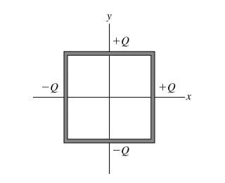

In summary, the electric charge is distributed uniformly along each side of a square, with two adjacent sides having positive charge and the other two sides having negative charge. When calculating the x-component of the net electric field at the center of the square, the x-components of the electric fields from the positive and negative charges should be in the same direction and equal in magnitude. Simply doubling the equation for an electric field does not work in this case because the sides of the square are charged rods and not point charges. The correct answer is -\frac{\sqrt{2} \cdot Q}{\pi \cdot a^2 \cdot \epsilon_0}.

Question:
Electric charge is distributed uniformly along each side of a square. Two adjacent sides have positive charge with total charge + Q on each. Each side of the square has length a.
Image at bottom.
Part A:
Suppose the other two sides have negative charge with total charge - Q on each. What is the x-component of the net electric field at the center of the square? Give your answer in terms of Q, a, and epsilon_0.
The electric field at the origin would point away from the positive charge and point towards the negative charge. The x-components would both be in the -x direction and equal in magnitude.
I thought all I had to do was double the equation for an electric field with Q as the charge and (.5a) as the distance.
My answer was - (2)*(Q) / (Pi* a^(2) * (epsilon_0).
Because this is a Mastering Physics question and I was close, my feedback was "Your answer is off by a multiplicative factor."
What did I do wrong?
You can't just double it. Since each side is a charged rod, you will have to find the electric field a distance .5a away from a charged rod. What you did would work if it were a point charge.
